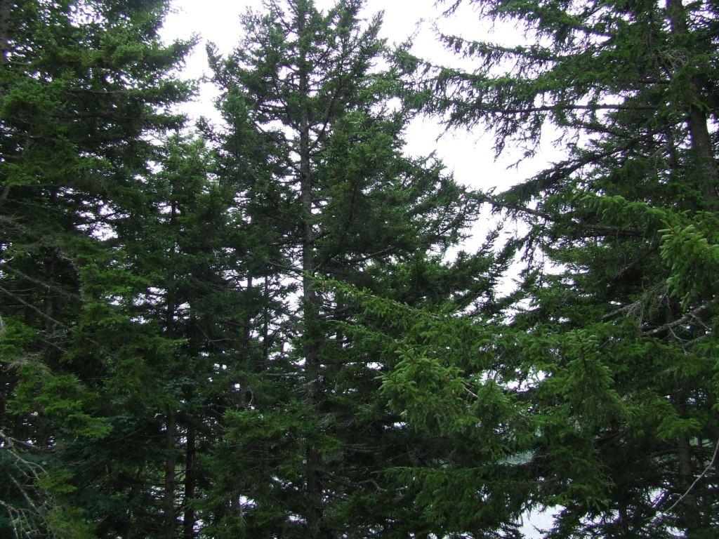

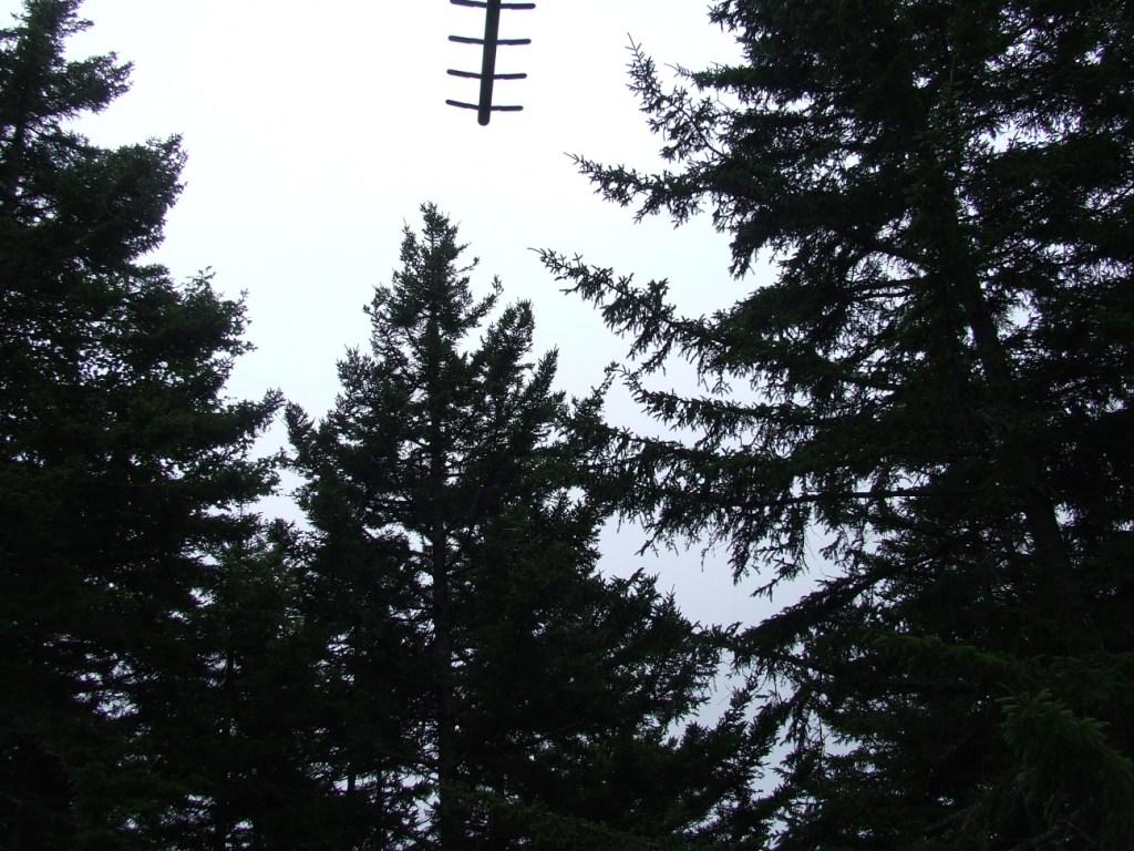

Here's a couple pics of what my antenna has to see thru to get to the transmitter. In one of the pics you can see the antenna at the very top of the pic and the tree that it is pointing directly at. After these trees is the lake and pretty much a straight run to the transmitter 63 miles away. No other hills in the way.
I think I can remove some of the trees but would prefer to not have to take all down. Do you think removing some of these will help?

Temporarily install the antenna on the other side of the trees with a long coax and, if needed, a pre-amp and see how it works there. That will tell you what needs to be done.

Looks to me like cutting down the first tree in the middle , straight ahead of the antenna will give a better view of the Tv transmitters.
Looks like the elevation drops very quickly down to the lake , and this would also produce a better view of the lake area for you and guests.
One of the many reasons for having a cottage is to enjoy the view , not look into one or two trees.

When it comes to cutting them it will be one at a time and likely that one in the middle, which is also the biggest, will be the first to go. Oh well, can always use a little fire wood.
