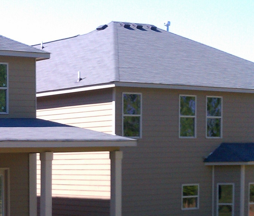

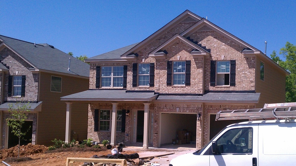

I'm trying to decide where best to locate the tripod mount. Do I understand correctly that tripod mounts are designed to straddle a peak? Or perhaps the proper term would be "ridge"? The line where two slopes meet?
I assume that two legs of the tripod will be on one side of the ridge, and one leg will be on the other.
My house faces south. My antenna will also be pointing south. I have a choice of mounting the antenna on a north/south ridge, or on an east-west ridge. I believe the prevailing winds come from the south-west. Is there any sort of preference between which way I orient my tripod?
I'll attach some pics. They're not very good, because I wasn't actually trying to get a shot of the roof when I took them. Note that both houses in the pictures are the same floor plan and have the same roof features. It seems like I can put the mount over that short ridge that runs sideways above the back face of the roof. Or I can put the mount over the ridge that runs to the front peak of the house.

You are correct on mounting the tripod. Try to get the screws that go through two of the feet of the tripod to go in to the rafters under the roof , makes for stronger mount of the tripod. Also can add a board on the under side of the roof and the screw will go through the roof and into the board , makes for stronger mounting. Most houses have prewire coaxes pulled to the location of electric service at the house , Reason: thats where power and ground is at. If your house is like that then run the coax from the antenna on the outside of the house along with the ground wire to the location of electric power and ground and have the grounding block there. Some houses have the prewire coaxes pulled to a location inside of the house and a coax/s go from that location to the location of electric power and ground.
