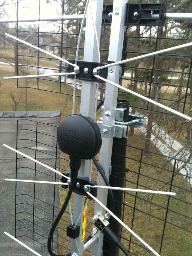

I ordered the C2 VHF reflector kit from Antennas Direct. I removed the dipole, wiring and diplexer from the reflector assembly. I attached the dipole to the DB4 by using an existing unused hole in the upper part of the antenna. It fit perfectly in the wider spaced grid on the upper reflector. I attached the adapter to the aluminum beam with a wire tie. I routed the cable down and attached the diplexer in another unused hole at the lower part of the aluminum beam. I was able to use the bolts from the c2 kit also. The only thing that wasn't supplied was the wire tie. This was a very simple modification.
My signal strength of the VHF station that I was wanting to improve reception of is now steady at 95%. Previously it was 45 to 55% and sometimes had no signal. The other stations which are UHF were unaffected and strong.
I removed the direct connection to my TV from the antenna and connected it to cable network system in the house and lost very little strength.
