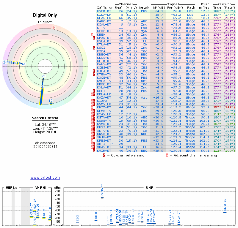

Here is a copy of my Signal analysis report ...

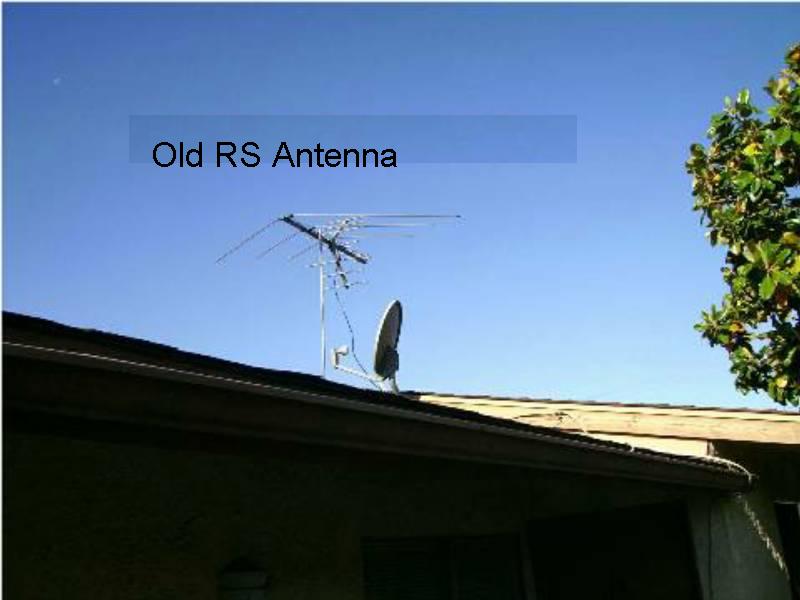

I been dealing with this for a month, and I think the only solution is to buy a new bigger antenna (which could be a problem because I live in an apartment). I have two antennas, Terk HDTVo and Old RS. With the RS I was receiving 24, 28, 40 and 46 but right now I only get 24.

I don't understand the issue; if you already have an antenna on the roof, why is it an issue to replace it with a larger antenna: it is a simple replacement? Based on the signal strengths available at your location: you are in a fringe-to-deep-fringe reception area for the LA transmitters: you should be looking at much more antenna than what you are using. Unless you are looking for some oddball stations, everything that you will want to see will come from Mt. Wilson, and won't require the installation of a rotator.
I would suggest using a Winegard HD-7696p. You need to pull the TERK preamplifier out of the system, since it is likely overloading on the two local transmitters in your area. You will need to use a high-input preamp like a Winegard HDP-269, which won't overload on your local signals while still amplifying the weaker LA signals. DO NOT use a high-gain preamp like the Winegard AP-8275 or the AntennaCraft, or you will overload them and lose channels! The Gain control on the AntennaCraft will NOT protect you from overload problems!
The biggest mistake that you can make is to assume that a preamplifier will substitute for a better antenna: a preamp can only work with the signal that the antenna provides. the Radio Shack antenna that you are using is their smallest antenna, and is not intended to work in a fringe areas such as yours. Using that antenna with a high-gain preamplifier is not going to do you much good, and will probably do more damage. also, if you are using RG-59 cable, yahk it out and replace it with modern RG-6u cable!

The issue with another antenna is the size...like I said is an apartment complex, and I got away with this small antenna (first I installed the Terk HDTVo (much smaller) then I replace it with the RS, I'm the only one who has OTA, everybody has satellite or cable, but I want to avoid that expense).
I already installed the rotator, channel 24 signal is strong if I point the antenna to the right place, but it works if is pointing to Mt Wilson too.

Can somebody tell me what can I do to improve reception (if it can be done with this antenna) or What antenna can I get to upgrade... I prefer to stay within 60" - 90" max lenght
I been considering winegard 7694p or maybe 7695p, another option is the Antennacraft HBU33. I want to avoid to get anything bigger......
From the tvfool list....I'm trying to receive all the way to KCET(28.1) or at least KMEX (34.1) then I'll be happy.

The Winegard HD-7694P has at least 3dB more gain (double the gain of the VU-75) across the usable TV spectrum, and more than 5dB gain in the critical UHF band, yet it's overall footprint is considerably SMALLER than the VU-75, especially in width. Buy the HD-7694P and add a high-input preamplifier like the Winegard HDP-269, use all new RG-6u coaxial cable, and you should find much better reception than you are currently experiencing without any appreciable increase in size.
