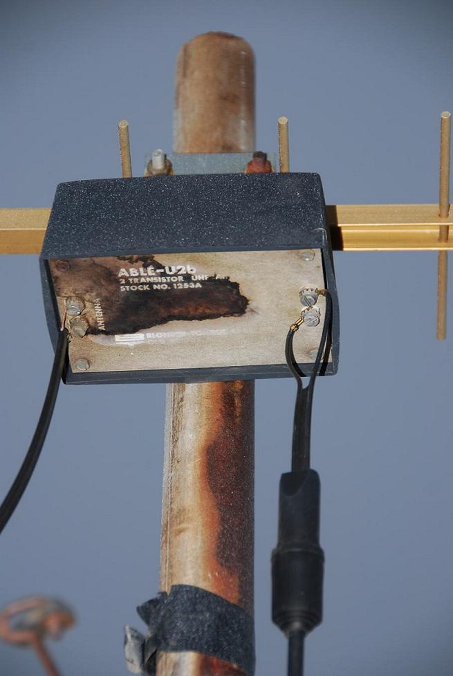

Hi all,
First time I have visited this site. Lots of good information here. I was hoping you could give me some advice.
I just moved to a small town in northern MT called Chester, zipcode 59522. I currently have a small antenna that is mounted on a short mast about 12 feet off the ground. The antenna is only about 24" long. See the attached picture. It also has a small box mounted below it which I think is part of an ampliphier, but there is nothing else in the antenna system. See the attached picture.
I only have one TV set up to this antenna and it is about 50' from the antenna. I recently replaced all the wire from antenna to tv with coaxial cable.
The current antenna system does not work the best. I can only get a few channels and they are almost too fuzzy to watch. If I could improve these channels, it would be great. If I could also pick up a FOX station, I would be estatic!
From what I understand from the locals, most of the TV signal boosters are on some hills to the north of me. I am willing to buy a new antenna, booster/ampliphier, what ever it takes to improve my current condition. If you could help me out I would greatly appreciate it. Thanks you very much.
Chandra
It looks like the amplifier than you have can't get power from the power supply. In most cases a balun is not designed to pass power. I'd start with a new preamp.
To figure out which preamp is optimum, please post your TV fool report.

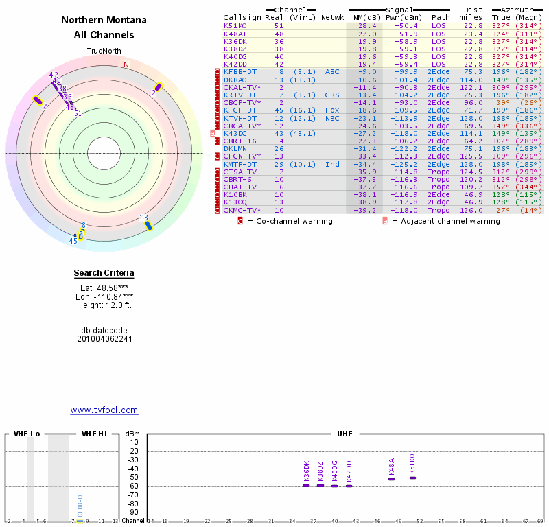

Sorry it took so long to get back. I had to borrow a friends GPS unit to get my coordinates. I actually live between two towns, Chester and Joplin. I put my coordinates in the TVFOOL Report and it is attached.
Tower Guy mentioned a preamplifier and not getting power, etc. I'm pretty stupid when it comes to this stuff, so you'll have to baby step me through it. I'd assume that whatever that box thing is, it doesn't work. Its pretty old.
The antenna may/maynot work. I don't know if they go bad over time or what.
So, with all this being said, what do I need to improve my current channels (those listed by Tigerbangs) and what can I do to get a Fox channel? In the attached report, I see that there is a channel 45 (FOX) to the south.
Thanks again Tower Guy and Tigerbangs!!
The antenna looks fine from the picture. As others have mentioned, the Blonder-Tongue preamp is probably not getting any power.
As a start, before you go out and buy a new preamp, try connecting your balun to the same screw terminals as the lead-in from the antenna. This will effectively bypass the antenna. (It would be even better to connect it to the antenna, and forget about the leadin. Don't do that yet, as you may end up having to reuse the leadin to connect to a new preamplifier in the future..)
That box thing needs power. Usually it gets it from the twin lead and a power inserter behind the TV set. You've removed the twin lead, and the power couldn't get through the coax to twinlead adapter (balun) that you've used anyway.
So, simply remove the box and connect the balun directly to the antenna. You should get all the analog low power stations that are still transmitting.
To get any digital stations you're going to need a taller mast or tower plus a larger and different type antenna with a new preamp.

With the exception of NBC, the major TV networks are available to her, and Global from Canada carries most NBC programs. The OP also seems particularly interested in FOX, which is available from the local mountaintop.
Tower Guy's observation about the balun transformer connecting the coax cable to the preamp is spot-on: I am sure that it is blocking the DC power from the preamp power supply, assuming that a power supply is even present.
I believe that the smart move here is to replace the existing preamp with a new Channel Master Titan 7777, and replace the twin-lead cable running from the antenna to the preamplifier input with a new short length of coaxial cable. Its possible that the antenna terminals on the antenna are old and corroded, in which case we may have trouble mounting a new antenna balun on the existing antenna.
The upshot of all this is that we definitely need to replace the preamplifier, and we MAY need to replace the antenna if the place where the antenna wire attaches to the antenna is badly corroded.
If we can use the existing antenna, we need to buy a weather-resistant balun like a Channel Master 0089/0090 to connect new coaxial cable to the new preamplifier. New preamplifiers usually use coaxial cable both in and out of the preamplifier. You will also need to install the preamplifier power supply inside the house before connecting it to the antenna connector on the TV set. Here is a link to an instructional video about the Channel Master Titan 7777
http://www.hdtvantennalabs.com/forum...eamp-t853.html
If we determine that the old antenna can no longer be used , or you simply want a better antenna than what you already have, consider an AntennasDirect XG-91 UHF antenna, which is probably the best, moderately-priced UHF antenna currently available: it can be bought cheaply from SolidSignal.com
http://www.solidsignal.com/pview.asp...u=853748001910
And here is the preamplifier:
http://www.solidsignal.com/pview.asp...ku=02057207774
With the combination of these two components, plus a short length of coax cable to run between the antenna and the preamplifier, you should be able see all of the local TV stations from the mountaintop clearly.
Remember to be sure that the antenna is aimed at 314 degrees plus or minus a few degrees, as measured by your compass.

I'm back again and want to thank you again for your assistance on this. After reading through all your responses, I have some points/questions to discuss with you further....
1) OK, the existing preamplifier is just the box on the mast, so I will eliminate it from my system. There is no power source. It also looks very old.
2) What is a balun? I guess I thought is simply converted the old flat tv antenna wire (300 ohm) to the newer coaxial cable (75 ohm). By your comments, I am assuming that it does more than this?
3) I re-ran the TVFOOL REPORT with a 50' mast and it did not significantly change any of the data. Only a few stations had changed and by only .1
4) I'm going to go ahead and order the Channel Master Titan 7777 preamplifier that Tigerbangs suggested. How do I make the connection between my existing antenna and the preamplifier? I'm assuming it will be a balun, but not the kind that I have on there now? Tigerbangs, can you give me a link to what I need? Where should I put the "inside the house" part of this ampifier? Are there any distance restrictions from the "outside the house" portion?
5) My current antenna is only about 24" long. The antenna Tigerbangs suggested looks like it is 93" long. This is huge! Not that it bothers me, I just need to find another place to put it. With the preamplifier discussed in #4, is there any coaxial cable length restriction that I need to pay attention to? Reason I ask is I have an old windmill tower a little ways behind my house, not too far, but it is real tall and might be a good place. Any thoguhts?
6) Lasly, Tigerbangs mentioned that there is a FOX station in the hills to the north. I think you accidentally put the wrong info down. Channel 42 is actually a NBC channel. I think the nearest FOX channel is Channel 45 which is 71 miles to the south (see attached TVFOOL REPORT). Would the antenna that Tigerbangs reccomended still work?

Let's see if I can help you with the information that's been presented so far, organized by the questions you still have:
1) You are correct about what the preamp is. However, there must have been power provided to it via the old wiring that you replaced. Typically, there is a power brick installed near the TV (for convenience) that ties to this wiring. Whether that thing still exists or not is not important, as you no longer can feed power to the old preamp via coax cable.
2) Your first impression of what a balun is is correct, and it is the barrel-shaped object with the twinlead "pigtail" that you used to connect the coax to the preamp. However, it does nothing more than that. kb2fzq described why the balun prevents you from being able to power the old preamp.
3) I'm not surprised that there was little difference to the first six stations on the list - you already have a clear shot (LOS means line of sight) at them at 12 feet. We were wondering if there would be any material improvement in the next group of stations that have to clear 2 obstacles to get to you. Apparently not.
4) The AntennasDirect XG-91 comes with a balun, so here's how you connect everything: Attach the balun provided with the antenna at the correct place; mount the ChannelMaster 7777 pre-amp on the tower, and run a short piece of coax cable from the antenna's balun to the pre-amp; attach the cable from the house to the pre-amp's output; inside, install the beige-colored power supply near the TV, connect the cable from the outside to the right point on that device, then run a short piece of coax from the other point to the TV.
5) Depending on the type of coax you have, you will lose from 5 to 8 dB of signal for every 100 feet. Assuming worst-case, you would have enough amplification to account for the losses in 300 feet of cable. Since higher is generally better for UHF reception, that tower should be an OK place to mount to if the cable run is less than 300 feet.
6) Tigerbangs was correct - one of the analog translators you can pick up (channel 42) relays KTGF, the Fox affiliate. The TVFool report does not usually list the Network for translators, hence your confusion. Tigerbang's post lists what each of those six translators carries, and his antenna recommendation is for picking up those translators, not the originating stations on down the list.

Well, I bought the Channel Master Titan 7777 and hooked it up yesterday. It works great! Thanks Tigerbangs! You were right on. I hooked it up to my existing antenna.
