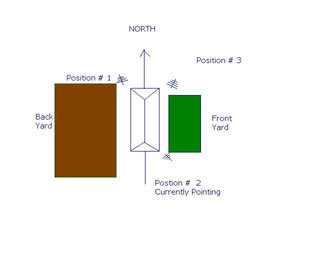

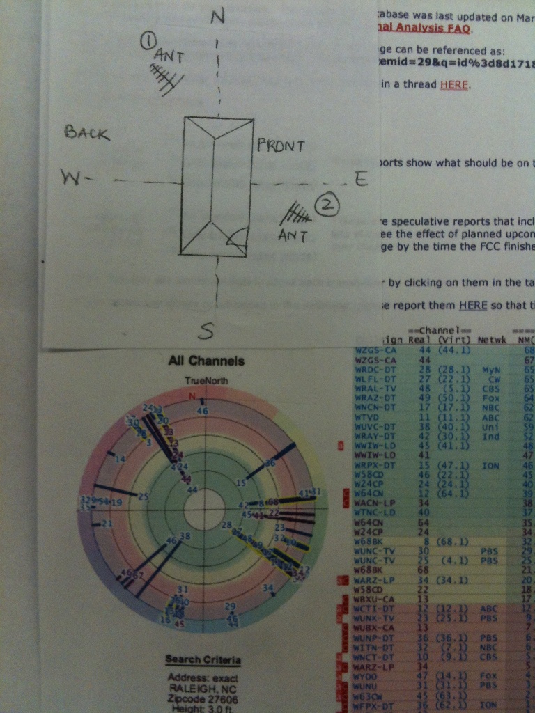

How should I aim my Outdoor Antenna (Diagram Attached) ?
I am in process of moving my Antenna from my attic to outdoors.
Probably on Front or Backyard.
However need advice on which direction I should point my HD Antenna.
I have attached my house sketch with proper orientation.
Should I point my ANT to Position 1 or 2 , please advice ?
Kindly let me know if I need signal AMP/Booster with this antenna, like this one Link ?
Tvfool Report Link
Ant.Type & Details :Clearstream4.
Don't have any tall structures (above 3 story high) around me.
I have single row of tall pine tress on the East side with wide gaps between them.

Aim toward the E or SE as a start... but take the time to sweep in small steps (5 to 10 degrees) to verify you have what you consider the best aim.
There are a few signals on high-VHF. If you can't get reliable reception of WTVD-ABC, you may need to add a high-VHF antenna.
You have quite a few strong signals close in. I would advise against an amplifier.

I have good reception of ABC without high-VHF antenna on my MAIN TV.
However other TV are unable to get ABC at all.
So you think adding high-VHF antenna is good idea for long run ?
So I should start from Position #2 and then sweep towards Position # 1 .

Let me see if I understand your advice clearly;
Try cheating the aim more northward to see if you can find a spot that makes everything happy. While I'd like to see it happen, but I'm not optimistic. The "classic" solution is to use a separate UHF antenna aimed directly at the ION station combined with combo aimed southeast via a UHF 15 Jointenna. Unfortunately, those products are becoming increasingly hard to get a hold of. The only seller I know of is Warren Electronics.
So should I try aiming my existing C4 towards Position # 3 as marked on the attached sketch drawing ?
Also you mentioned "separate UHF antenna", thats why I got the C2 & CM 4220MHD , so that I can try one of these to point it towards ION separately ?

Should I position it towards North-ish (Position #3 on my attached sketch) or E-SE (existing C4 orientation ) ?

So mounted my C2 antenna facing Position #3 ( see attached sketch - Facing more towards N-NE)
Pic Quality is Same (Very Good)
Signal Strength went from 94% down to 89% for ION
I see more black outs , however rarely I saw any pixelization then before.
When I was using C4 facing W-SW i.e Position # 2, there was some pixelization on all ION Channels. However there was rarely any BLACK OUTS.
Any suggestions, should I stay with C2 in Position # 3 (N-NE) or C4 facing (WS-S) ?
