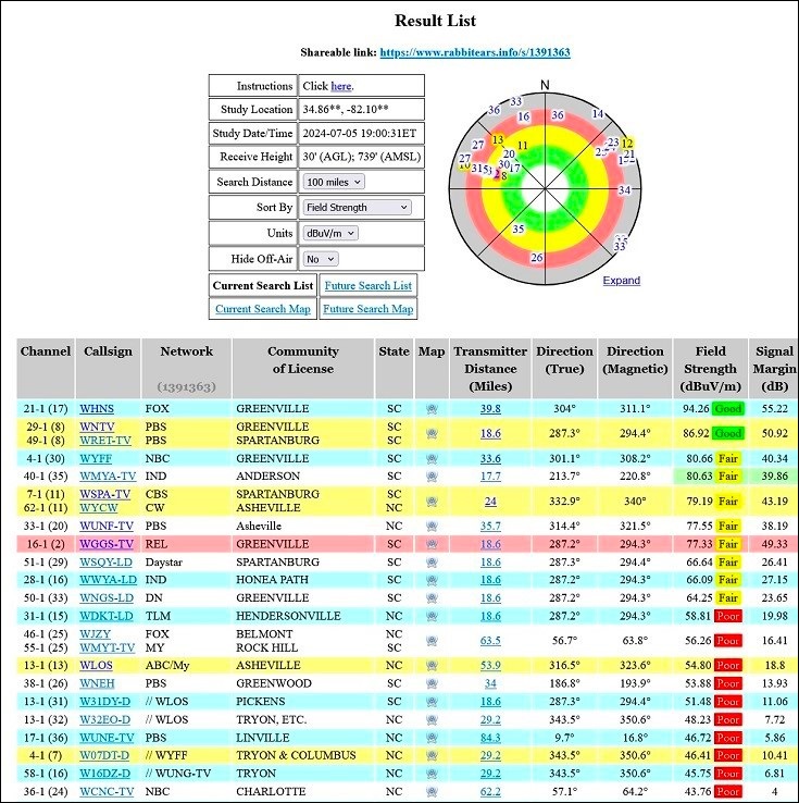

I did a new signal report for her location:
https://www.rabbitears.info/searchma...udy_id=1391363

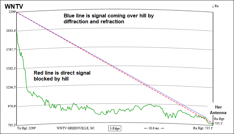

I can see the hill trying to block the signal:
I thought about getting one of those RCA Directional, or a Channel Master Bow tie...
A UHF antenna would be suitable for WHNS, WYFF, and WMYA, but you will need an antenna designed for VHF-High channels WNTV and WSPA and a preamp.
