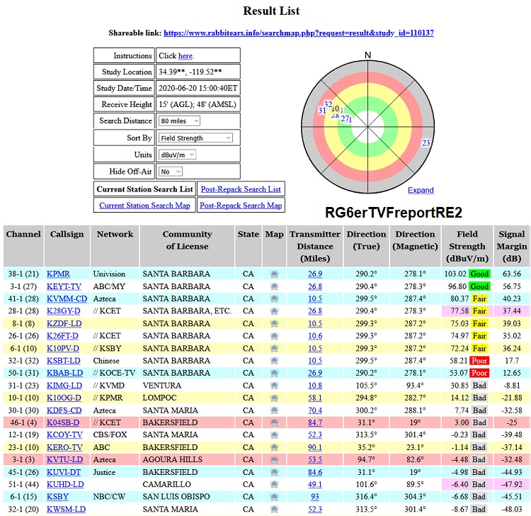

As OTAFAN mentioned, TVFool reports have become less accurate because of a defective database used to generate reports and many changes from Repack by the FCC. Here is a report from rabbitears.info based on your TVFool report. I don't have your exact address, but I think it's close:
https://www.rabbitears.info/searchma...tudy_id=110137

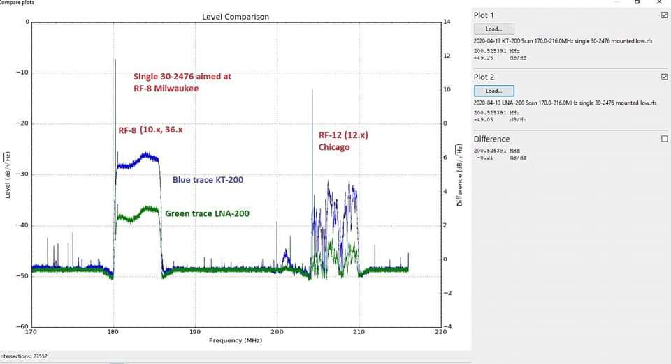

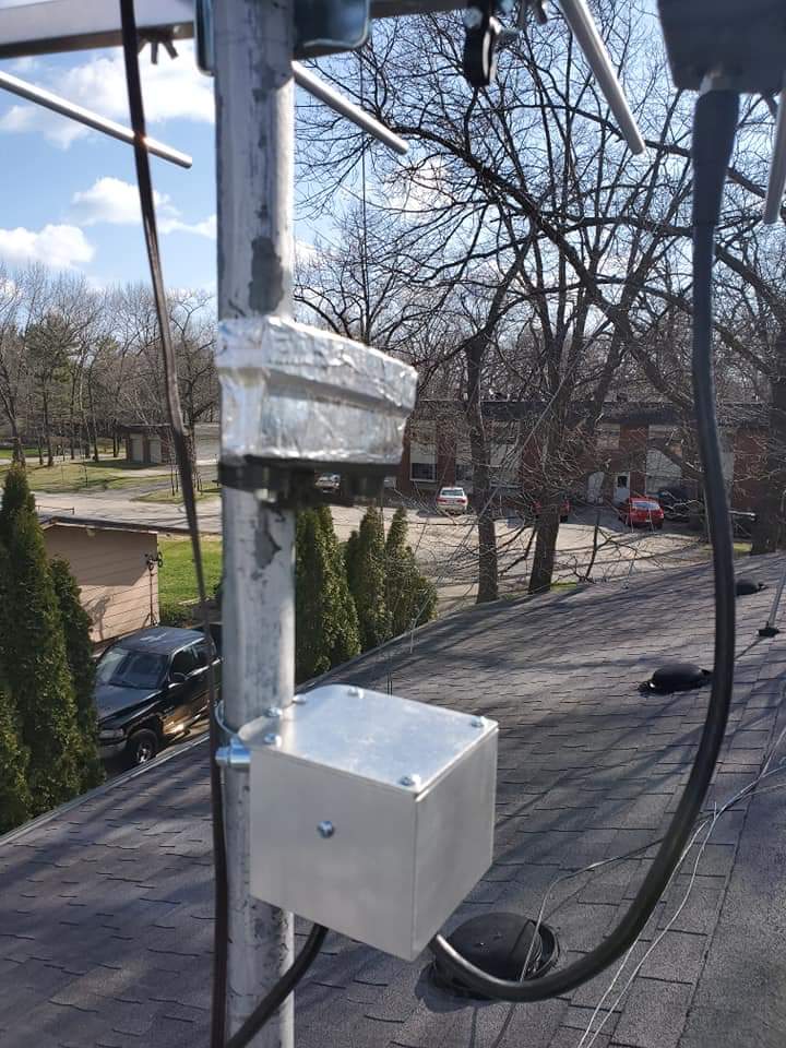

The only suggestion I could make is to get a Stellar labs 30 - 2476. It's one of the very few VHF High only antennas made these days.
I'm pretty sure it will help perform any of the other VHF combos. You could get a UVSJ and combined the VHF antenna with your other antennas without any penalties on the UHF side. Also, if noise is an issue or signal strength I could recommend a Kitz Technologies KT - 200 preamp. They have some other preamps but the main thing they feature is low noise. Low noise is very useful when you have a weak signal you're trying to pull. I am not a big fan of the Winegard LNA-200. Especially on VHF High.
