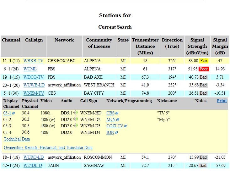

My mom lives in Oscoda, MI. I thought about placing the antenna on the roof on her ranch house. As you can see from the report, there isn't much that is viewable. She does have an RCA ANT751E that works well for WBKB 11.
I thought if I upgraded she could maybe pull in WDCQ & WNEM. Any antenna recommendations or is this just a pipe dream?

If you can mange to install the antenna high enough to avoid nearby obstructions such as trees and buildings, the the CM-4228HD, Antennas Direct DB8e, Antennas Direct 91XG, etc. would likely add one or two stations on real channels 20 & 24 (WUWB, WCML). This may require a rotator to optimize the aim each time you change channels (and others possible pros & cons)... But there may be off and on DX reception in addition to what the reception report suggests.
That said, none of the antennas listed above have intentional support for any of the VHF frequencies. Another option to consider would be a Winegard HD7698P which covers the UHF band as well as real channels 7 through 13.
(Based on you TVFool report and rabbitears.info https://www.rabbitears.info/searchma...&study_id=1974)

Originally Posted by Spencer View Post
Are there any high gain antenna's that will only get VHF-HI 7-12 and UHF 13-36 that aren't huge?
VHF-High real channels are 7-13
UHF real channels for reduced band are 14-36
High gain antennas must be bigger for increased gain.
The next step up from the RCA ANT751 for VHF-High and UHF is the Winegard HD7694P.
I suggest you go with GroundUrMast's idea:
Given that you already have the RCA ANT5751R which includes reception capability for real channels 7 through 51 you could opt to combine it with a large UHF only such as those already mentioned. A UVSJ (UHF/VHF combiner) and coax cables are all that would be needed to accomplish that.
Aim the 751 at WBKB and a high gain UHF antenna at WDCQ and WNEM.
The Winegard HD7694P is only rated for 45 miles. WCML is 61 miles away.
https://www.solidsignal.com/pview.asp?p=hd7694p
Yes, that is why our later advice was for separate UHF and VHF antennas, with the UHF antenna having higher gain than the UHF section of the 7694.
High gain UHF antennas that are needed for weak channels are very directional. They must be aimed directly at the transmitter. Your UHF channels are in different directions.
