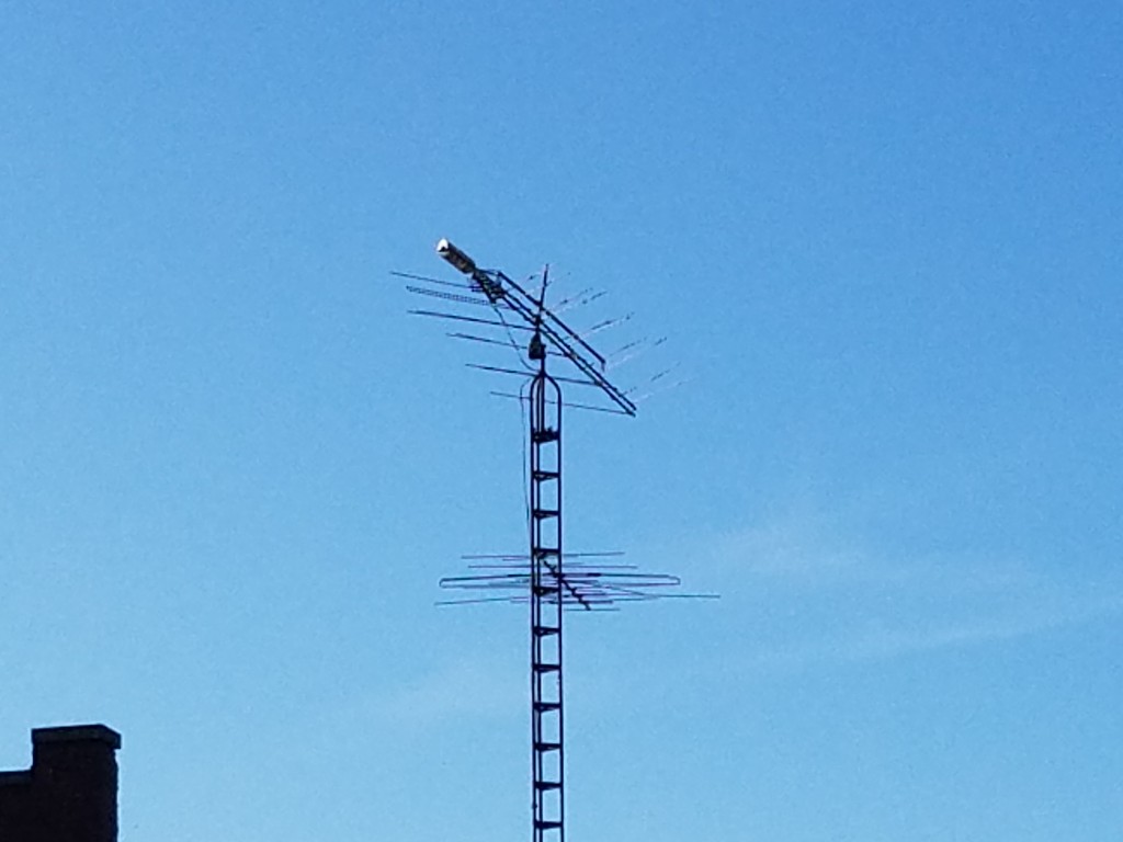

Just for fun.

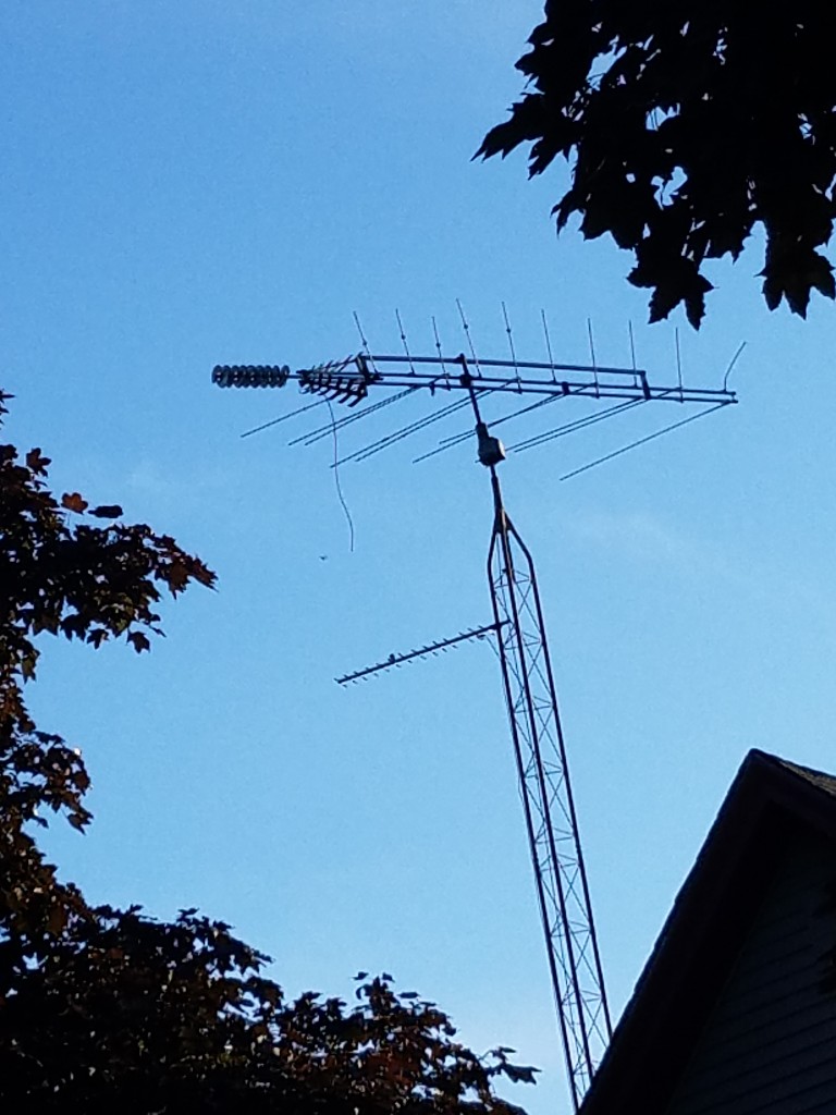

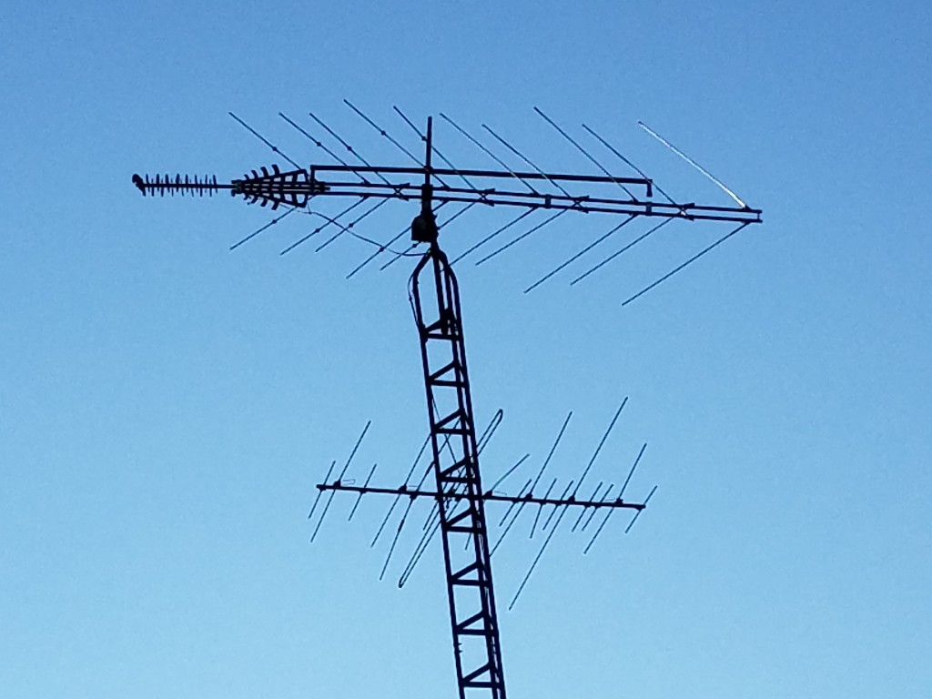

While driving around K-Town, I found these 2 antennas with a strange-looking device at the UHF / reflector end. I believe the two antennas are different models possibly from the same manufacturer. Strangely, one of the antennas has double elements on one side but not on the other, as far as I can tell. Is it possible that all the elements on only one side of that antenna got broken off in an ice storm or something?
I've never seen this particular antenna before and it's even weirder that I found another one just like it a few minutes later.
Would anybody be willing to identify these and what type devices that I zoomed in on in the final attachment?

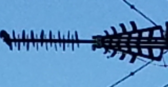

Here's that weird-looking basket type device. Is it a reflector?

I think both antennas are VHF, except the third photo where the second antenna is obviously some sort of UHF director. But the "area 51" stuff on the front end of the larger top antenna, could be some super duper UHF reflector and such. (Or maybe it's even alien technology LOL???)

The top antenna in the 1st image above is a JFD UHF/VHF combo.
In Bobs 1st image, the front of the antenna is on the left, the part on the left is the UHF section.
The disks are directors, the part to the right of the directors is the UHF driven part
(stacked log periodic UHF elements).
The remainder V-log portion using tubular elements is a V-Log antenna for Hi and Low VHF.
The bumps in some of the tubular elements are capacitors.
The capacitors shift the relationship between the fundamental (Lo VHF) & 3rd harmonic (Hi VHF)
The capacitors allow more elements to perform the dual function (Hi/Lo resonators).
The lower antenna in the first image appears to be a VHF-only 'Area Special'.
An Area or Regional Special was custom built by a manufacturer to accommodate specific locations.
Situations like where the main signals were coming from different directions.
That particular antenna appears to be designed to receive VHF-Lo and,
VHF-Hi from the left, while simultaneously receiving VHF-Hi from the right
(possibly VHF-Lo as well but not enough detail in image to determine).

Those area antennas look like "Cut" antennas for a specific channel. ONTV Ch 44 from the early 80s would be an example. The one w/ the bird perched on it looks like it may be up the street from me.
