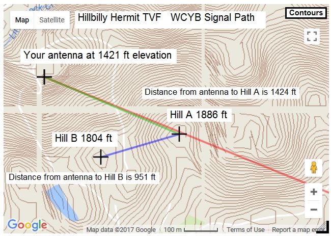

WCYB is on VHF-Low real channel 5, which requires a BIG WIDE antenna with LONG elements.

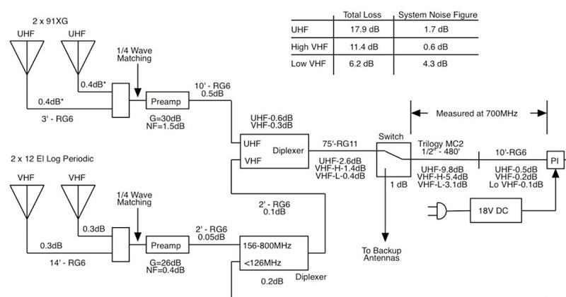

Calaveras at AVS Forum has much longer run of coax; 575 feet of which 480 feet is 1/2" hardline. He uses a high gain preamp at the antenna and increases the voltage sent up to the preamp by the power inserter so that there is sufficient voltage for the preamp to operate.

Your coax run to your closest hill, Hill B, is 951 feet, but the signals are stronger at Hill A, which is 1424 feet away.
If you moved your antenna to Hill B, you could try the 7777HD preamp at the 30 dB high gain setting with RG6 Quad solid copper center conductor. You would need to increase the voltage sent to the preamp from the power inserter inside, or power the preamp at the base of the 20 ft mast on the hill.
