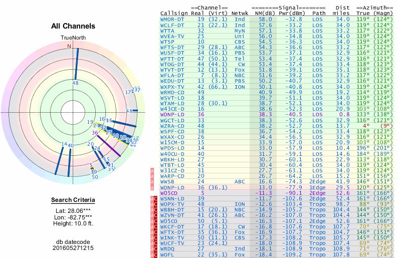

He means the TVFool signal report. You gave this link for it in your previous thread:
http://www.tvfool.com/?option=com_wr...e2cbfa8fc32d44
It has the database datecode 20165271215. It will probably be dropped from the TVFool server soon, so here is the image:
The strength of the signal can be stated in two ways, by signal power in dBm or by Noise Margin in dB.
I did the analysis in your previous thread, post #14:
http://forum.tvfool.com/showpost.php...3&postcount=14
