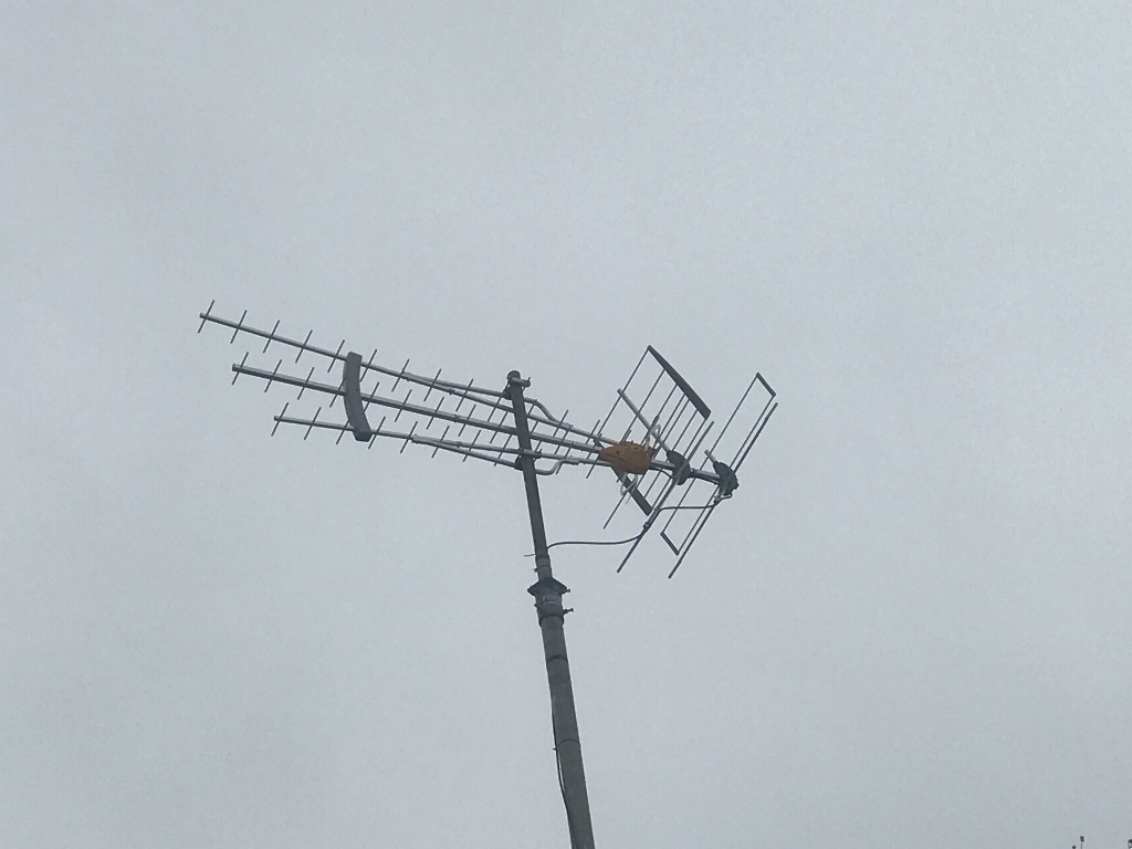

Antenna best reception not in front
I have been trying different directional antennas. I have never run into this problem before but this antenna receive pattern seems to be off about 30 to 35 degrees. The receive patterns seems to be off to just one side of the front of antenna. The antenna is a Televes DAT BOSS MIX LR uhf/vhf. The stations that I am receiving this way are the ones that are over 40 miles away. The closer one have full signal meter reading on the Samsung tv. I have sent pic of antenna and any reasons why would be helpful. Thanks John PS I did look up the physical locations of those stations to make sure I was pointed in correct direction.

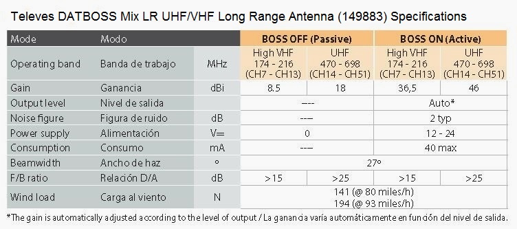

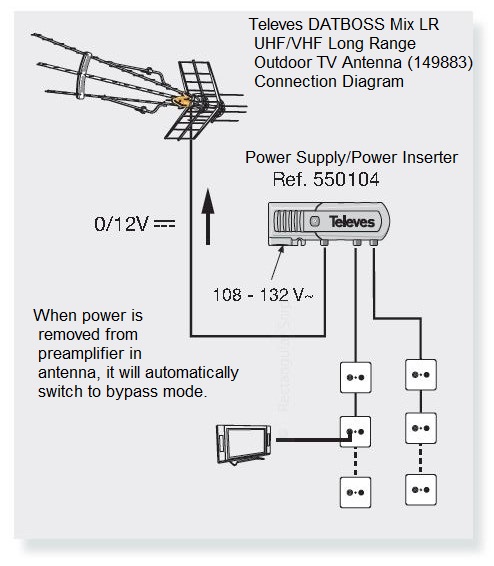

From your photo it looks like you have the 149883 Kit, which is the 149821 antenna + the PSU-550104 power supply/power inserter.
You haven't shown us your TVFool report, but if your other antennas didn't act this way, my guess is that the preamp in the antenna is being overloaded by strong local signals. When you rotate the antenna, the overload is reduced and you are able to receive the weaker signals.
The preamp in that antenna is unusual. When you remove its power, it goes into bypass mode. Try unplugging the AC power from the power inserter, or completely removing the power inserter.
From the Solid Signal Technical document:
https://www.solidsignal.com/pview.asp?p=149883
http://forums.solidsignal.com/docs/H...n%20149883.pdf

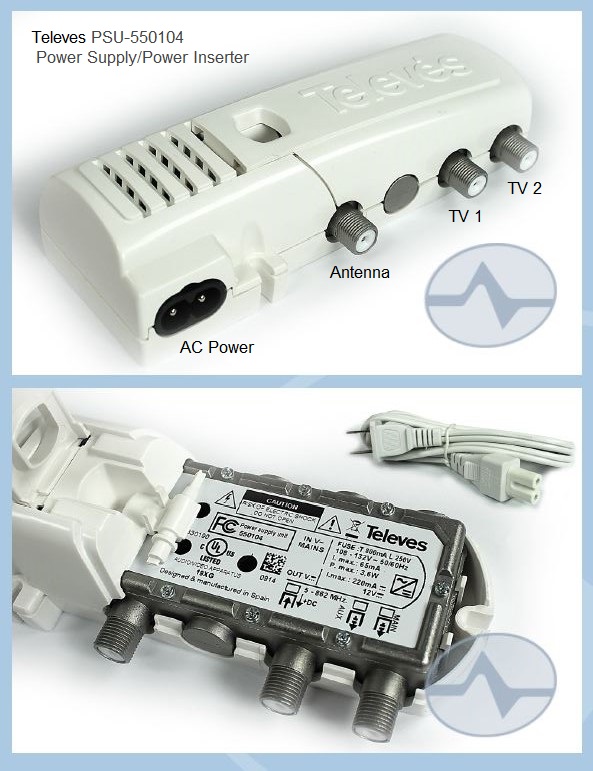

That’s why the DATBOSS Mix LR is passively amplified, and it’s one of the few antennas on the market that is. Most amplified antennas won’t work at all if they’re not powered, but the DATBOSS Mix LR will. If you don’t need an amplifier, don’t use it.

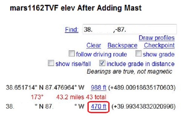

The DATBOSS Mix LR includes this power injector that sends power up to the amplifier and also lets you run up to 2 TVs without adding an additional signal. It plugs into the wall inside and safely does its job. If it becomes unplugged, the antennas will still function and the power supply may be completely bypassed if you don’t feel you have a need for amplification. If you are less than 30 miles from broadcast towers or if you see odd interference on many channels, you may not need an amplifier and may be better off without it. It’s your decision. While this power injector looks like Televes’ own distribution amplifier, it does not have any amplification within it. The amplifier assembly is located within the antenna itself.
From the Product Manual:
https://manuals.solidsignal.com/149883_manual.pdf

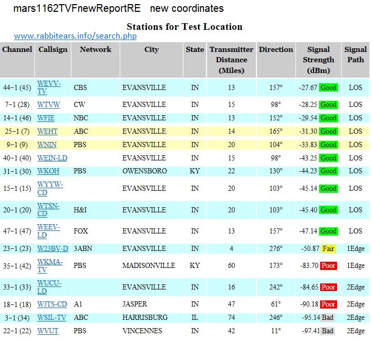

Yes, I also would like to see your TVFool signal report to help me understand your reception problem and learn a little more about the Televes preamp that has AGC.
Originally Posted by mars1162 View Post

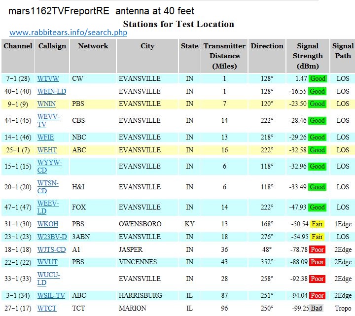

WFIE is not showing on my channel search on TV Fools signal strength map with all the other stations in my area. It is about 13 miles from my location. Their tower is located in Henderson KY on Wolf Road. It is listed locally as channel 14 on a 1000 foot transmitting tower. It may really be on channel 26
You are correct, it isn't on the TVFool report. I picked a location at random in Henderson:
http://www.tvfool.com/?option=com_wr...9038260d5e86fe
and then I used the same location for a rabbitears.info report which shows WFIE NBC (the page takes a long time to load when signal strengths are requested):
https://www.rabbitears.info/search.p...=dBm&height=25

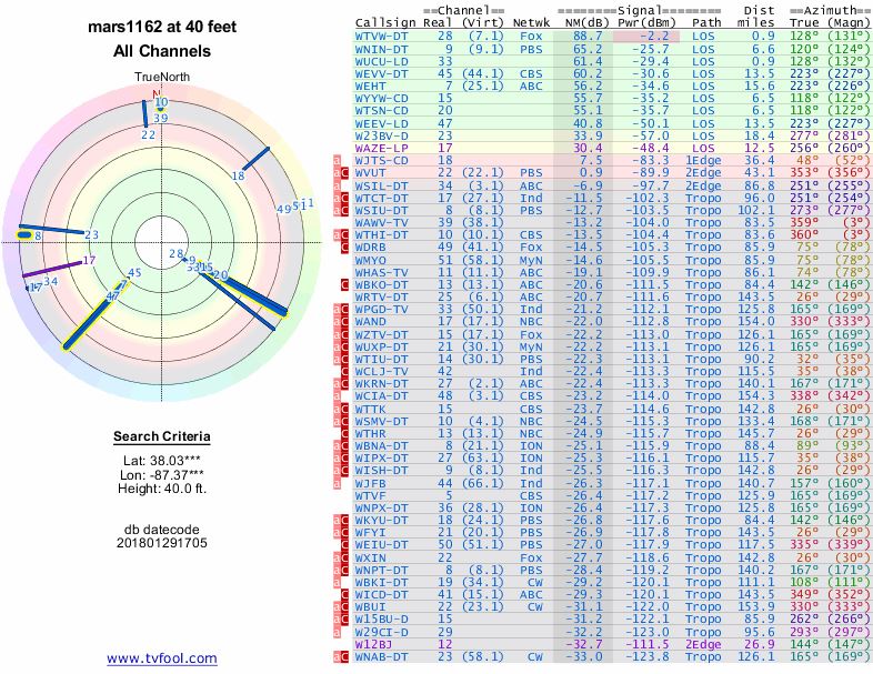

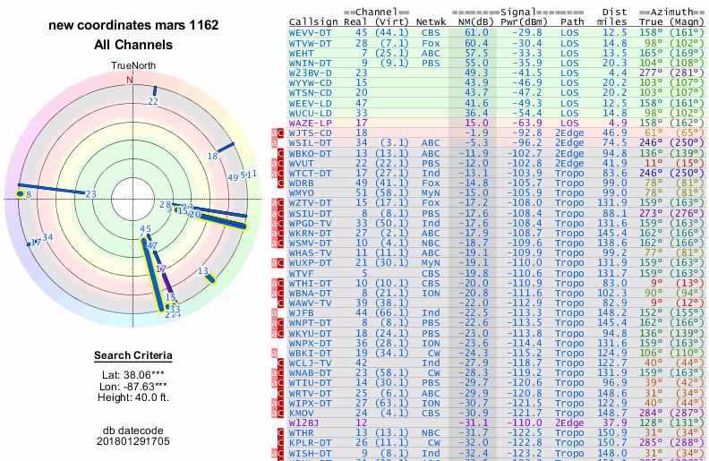

Ok here is my TV Fool Report http://www.tvfool.com/?option=com_wr...9038b9ec20c134 Rabbit73 & ADTech Antenna worked as should as far as receiving best dead in front with the amplifier on antenna not powered. Or shall we say bypassed. I did lose 2 stations without amp on. They are WSIU Carbondale IL and WTUV Vincennes IN. WSIU is not on my plot map. Virtual 16 and actual 19 I think. You guys were right I think about the variable gain on amp causing the signal to seem skewed on antenna.Thanks a bunch for the info and help.

Thank you for making the test and for the TVFool report. Your report shows WTVW with a signal power of -2.2 dBm highlighted in red, which is an overload warning. A preamp is contraindicated unless you insert a custom filter before the preamp to attenuate real channel 28.
I had been wondering about the Televes preamp that adjust the gain. It might work at a location with all weak signals or all strong signals, but with a mixture of weak and strong signals, it is the wrong choice. Your location was ideal for the test; it showed the weakness of the concept. We appreciate the report of your experience; it will help us when giving advice to other posters.
The best clue you gave is when you said you had to rotate the antenna off-azimuth. That reminded me of a case in Las Vegas. The poster was using one of those cheap "150-mile" antennas that also have a preamp with waaaay too much gain. He also had to aim off-azimuth to prevent overload. The only reason to use a preamp with that much gain is when you have a very long coax line after the preamp to compensate for the signal loss from coax attenuation.
WSIU is on your TVFool report, but it is not on your rabbitears.info report because it is more than 100 miles away. As before, NBC is not on your TVFool report, but it is on your rabbitears.info report. There is no WTUV; it doesn't exist.

Your report indicates that a preamp should not be used. If you must use a preamp, it should be a medium gain preamp that is resistant to overload like the Antennas Direct Juice. Even then, you would overload your tuner and need to add an attenuator before the tuner.
What weak signals are important to you? When you have very strong local signals and you also want some weak signals, there will be a great difference between the two. Your system is only able to receive a limited dynamic range. You must tailor your signals to that limited range.
When your strong local signals begin to cause overload, it will produce IMD (Intermodulation Distortion) that will create spurious signals in the preamp and in the tuner. These spurious signals (spurs) raise the noise floor and wipe out your weakest signals because their SNR is reduced below the minimum required 15 dB.
The goal is to have just enough antenna gain and just enough preamp gain so that you can receive the weakest desired signals without causing overload from the strong local signals.
WTVW has a Noise Margin of 88.7 dB even before adding any antenna or preamp gain; clearly overload territory:
If are not happy with your present antenna with its preamp OFF and you want a system that gets weak signals at your location, you will need an antenna system like this:
antenna > custom CH 28 bandstop filter > attenuator if needed > overload resistant preamp > coax > grounding block > power inserter > TV
Grounding the coax with a grounding block connected to the house electrical system ground helps to reject interference.
You might also need an FM filter; you have some strong local FM signals that might cause interference to TV reception:

WVUT is much weaker than your strong local signals. It got wiped out from overload AND it has possible adjacent channel interference from W23BV on real channel 23. The highlighted "a" next to the WVUT callsign in your report indicates adjacent channel interference; the highlighted "c" indicates co-channel (same channel) interference.
WVUT will be moving to channel 31:
https://www.rabbitears.info/market.p...&callsign=wvut
This is the point: Because of the very strong WTVW, you need a separate antenna and preamp, not an antenna with an integrated preamp. They must be separate because you need a filter between the antenna and the preamp to attenuate WTVW.
The only other alternative for your location is just an antenna with no preamp.

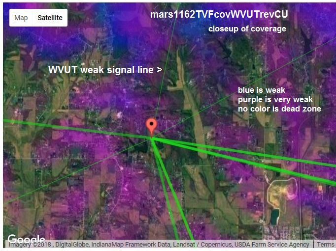

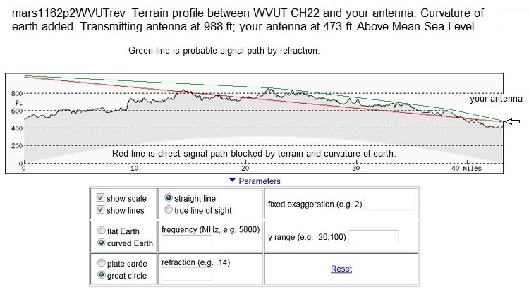

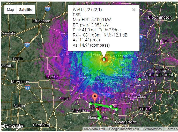

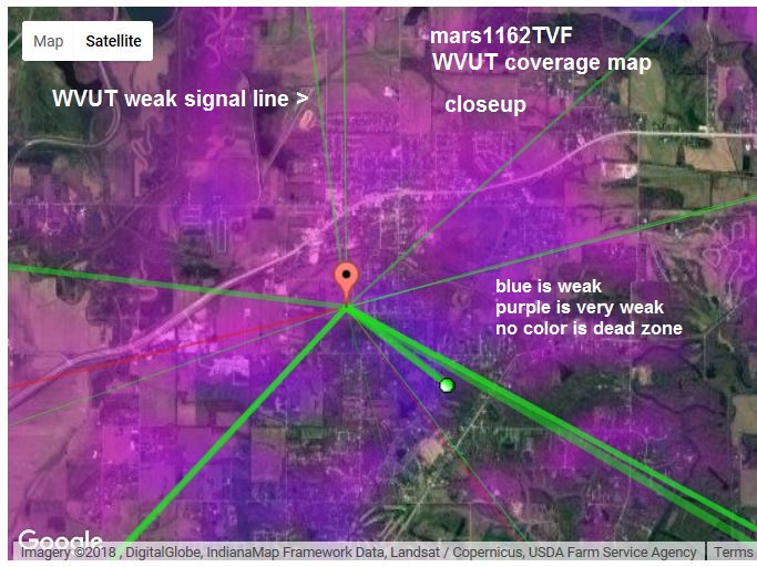

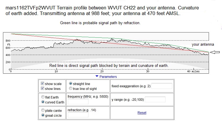

Here is the terrain profile for WVUT that shows how the signal is blocked by terrain and the curvature of earth:
The coverage map shows you are on the fringe. Note that only 21 kW out of 57 kW ERP is sent in your direction because of the directional pattern of the transmitting antenna:
closeup of coverage

To answer your question:

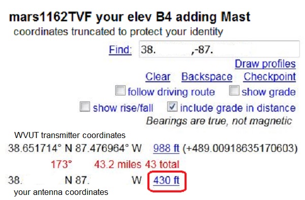

1. In order for me to run a terrain profile, I need to know the coordinates of the transmitting antenna and its height above ground level (AGL) and the coordinates of your antenna and its height above ground level. Since you haven't given me the coordinates for your antenna in a PM, I had to GUESS the coordinates for your antenna and enter them into the profile software.
2. Different sites will give different answers for the elevation of specific coordinates.
I got 432.0 feet from:
https://www.freemaptools.com/elevation-finder.htm
I got 433 feet from:
https://www.whatismyelevation.com/##
click on Change location to enter coordinates and press Enter
The site that I used for the profile gave me 430 feet before adding the antenna height of 40 feet above ground level (AGL):
http://www.heywhatsthat.com/profiler.html
If you send me the coordinates for your antenna in a PM, I can run it again. Or, you can run your own profile in the link just above.
I sent the coordinates I used in a PM to you.
I have no desire to argue with you about elevation or what antenna you should use. It is your antenna, your money, and your decision.

Thank you for the coordinates by PM. My guess was only 150 feet away, so the profile is similar.
I am showing ground elevation at my antenna to be 493 feet and with antenna on a 40 foot pipe that would be roughly 533 feet above sea level.
The elevations from 3 sources for your location were 430, 433, and 433 feet, so I'm wondering where you got 493.
