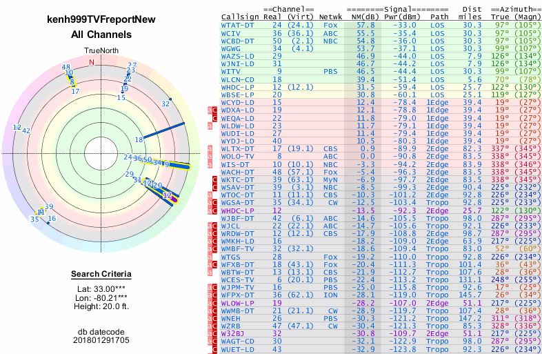

TVFool is using a defective database for reports, so there will be errors.
This thread tells the story about the problem:
***RESOLVED 1/30/18!!!*** WAS: Alert*** New database has serious issue ***
http://forum.tvfool.com/showthread.php?t=16376

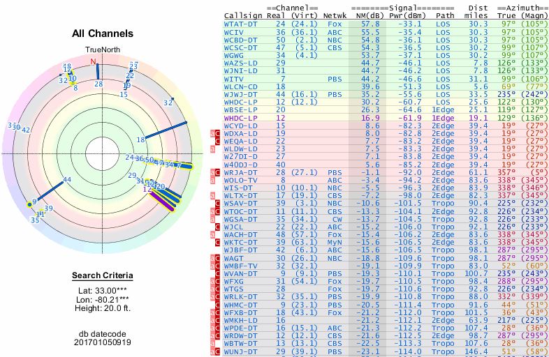

Your old report is using the database datecode
201701050919, which shows WCSC:
a new report has WCSC missing:
http://www.tvfool.com/?option=com_wr...90385ca250da94

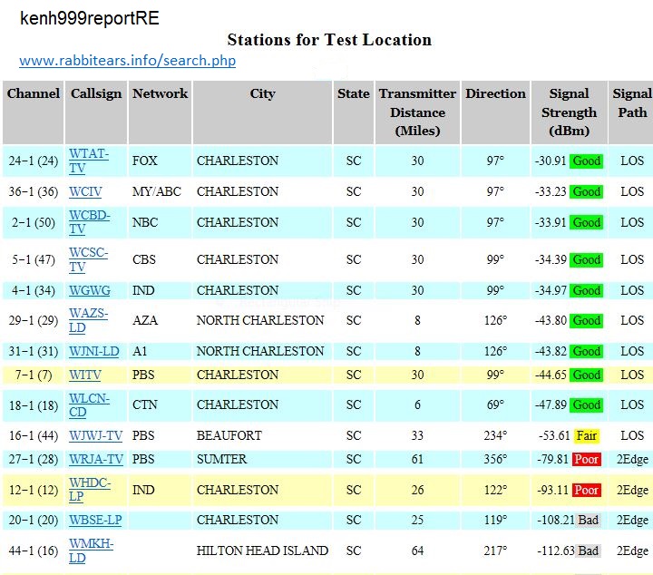

but WCSC shows on a rabbitears.info report:
WCSC will move to channel 19 because of UHF Repack:
https://rabbitears.info//market.php?...&callsign=wcsc
