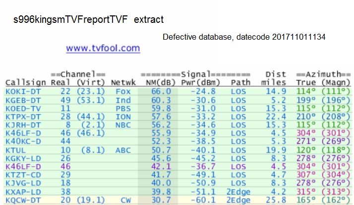

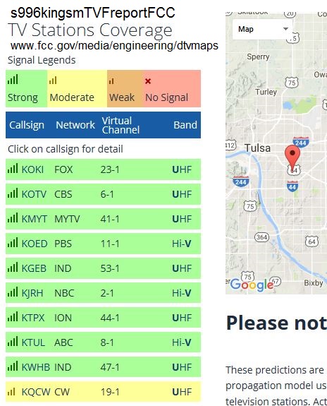

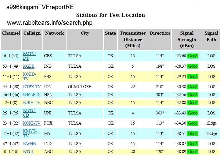

TVFool is using a new database for the reports that has a lot of errors. This causes channels to be missing from reports. The datecode of the new database is 201711011134, which you can see on your report. In your case, KOTV CBS real channel 45, virtual channel 6.1, is missing from your report.
http://www.rabbitears.info/market.ph...&callsign=KOTV
The KOTV channel 45 transmitter will be moving to channel 26 because of the Repack by the FCC which will shrink UHF TV to 14-36. The channels above that will be given to the cellular companies.
KOTV shows on a report by RabbitEars
and on a report from the FCC DTV map site
