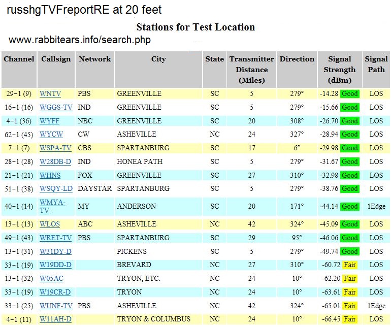

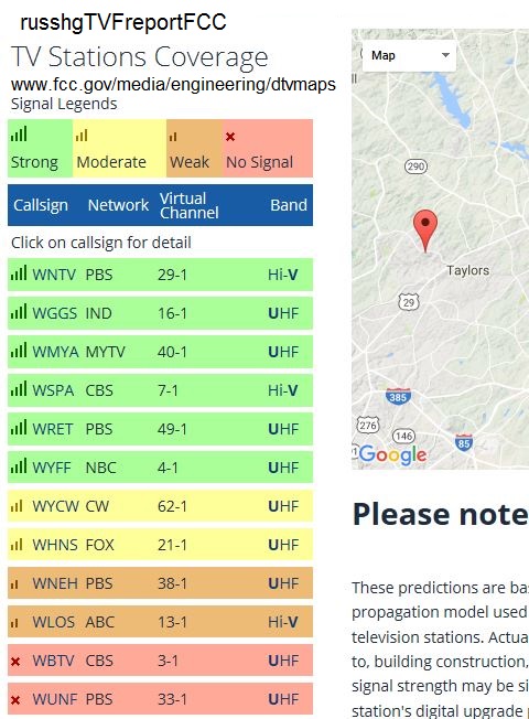

Hello, Russ
The channel list for your location from RabbitEars.info is probably more accurate:
The FCC DTV maps site doesn't list translators
What network are you looking for, ABC? W31DY in Pickens has it if you can't get WLOS:
http://www.rabbitears.info/market.ph...callsign=w31dy
It's a wonder you get anything with your antenna at 20 feet in all those trees:
You have some strong local FM transmitters that might be causing interference to WLOS on real channel 13:
http://www.fmfool.com/modeling/tmp/3...6/Radar-FM.png
An FM filter might help:
