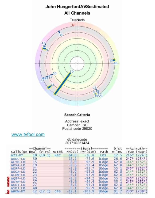

Old 30-Oct-2017, 10:29 PM   #8
The FCC map site compared with TVFool:
The FCC list shows 7 strong channels, but the TVFool list only shows one: WIS.

Old 30-Oct-2017, 11:27 PM   #9
JoeAZ
Join Date: Mar 2017
Posts: 418
And....... the stations call letters don't match up as well,
except for WIS TV.
