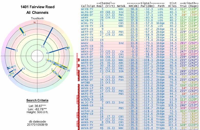

This is the image report that you gave in your previous thread:
Thanks for the signal report image for this new thread. I see that you have entered an antenna height of 500 feet. Do have a 500 ft tower at 1401?

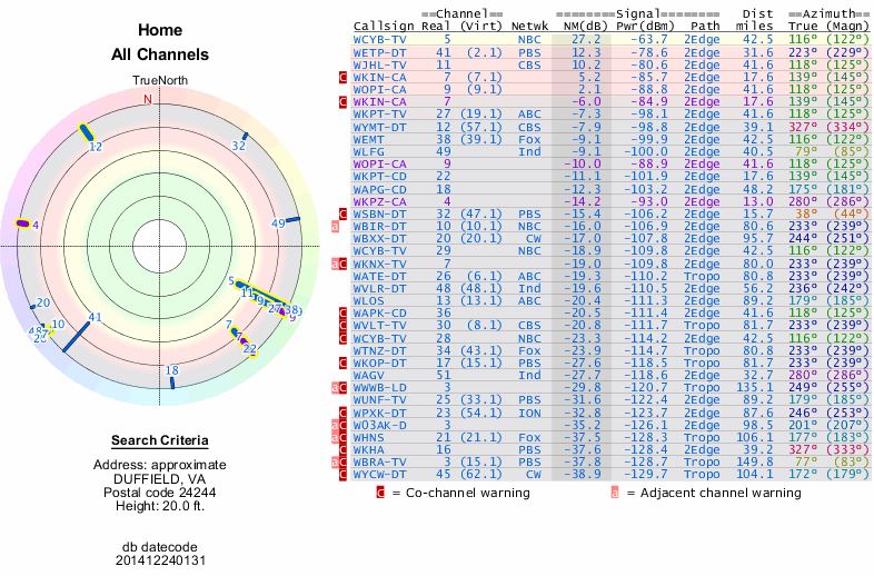

This is a report at 20 feet based on the 1401 location in your image:
http://www.tvfool.com/?option=com_wr...e6a49b16d0a52d

your report at 50 feet
http://www.tvfool.com/?option=com_wr...e6a42d0ed01454

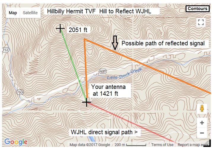

If I cannot get direct signals, I am hoping that maybe I can get reflected signals.
You might be able to receive WCYB and WJHL directly or from a reflection off the hill just north of the highway with the big Solid Signal HD8200XL antenna and a preamp.

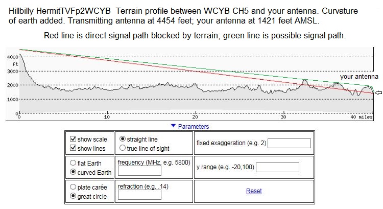

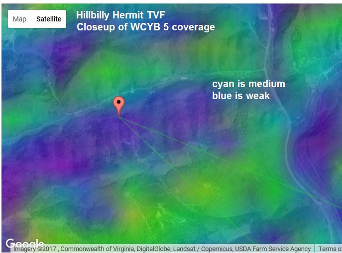

This shows the hill just south of your location that blocks the WCYB 5 signal:

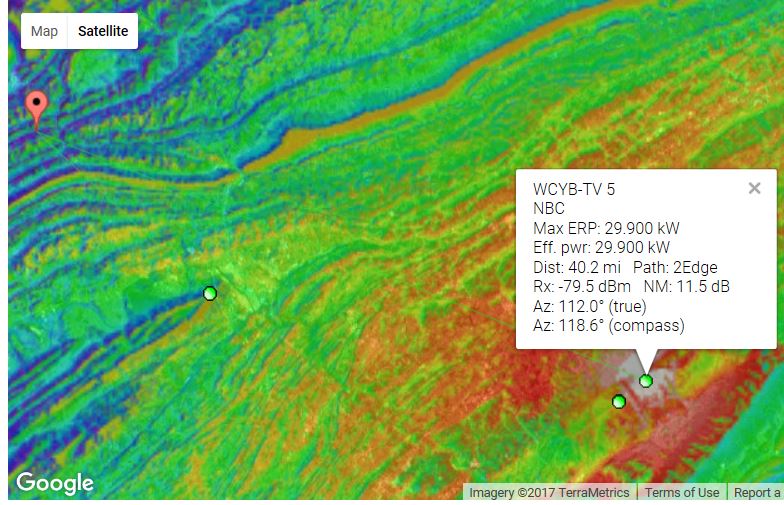

The WCYB signal coverage is very spotty in rough terrain:

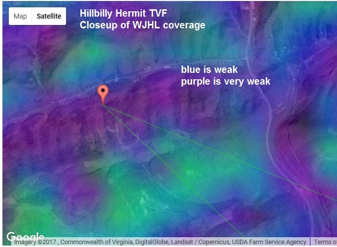

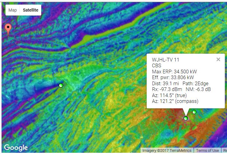

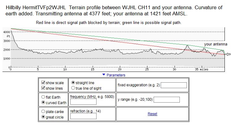

The hill also blocks WJHL:
WJHL is weaker than WCYB:

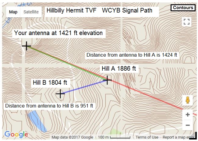

This is a contour map of the WCYB signal path and two hills:
WJHL signal path with hill coordinates:

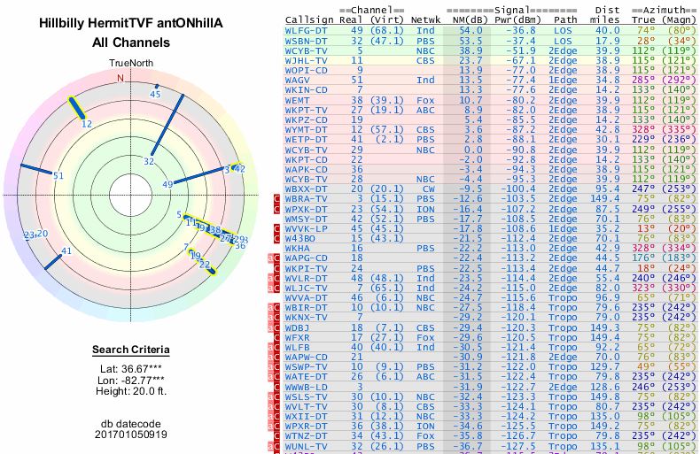

TVFool report if your antenna is on Hill A:

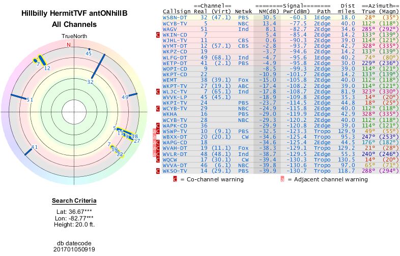

TVFool report if your antenna is on Hill B, which is closer to your house. The signals aren't as strong as on Hill A, but stronger than at your house:
http://www.tvfool.com/?option=com_wr...e6a4f2c4f2f960

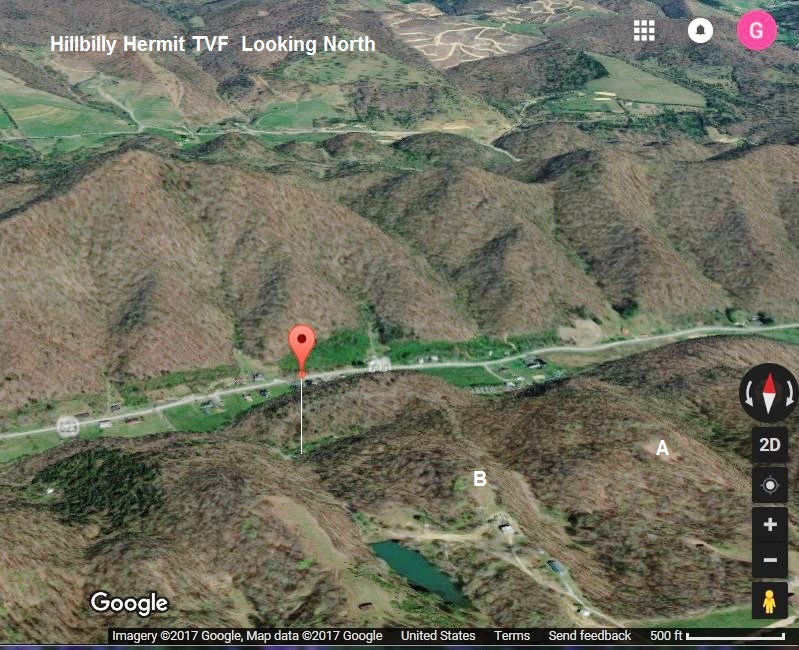

Oblique view looking North, showing your location and Hills A and B:

What if he got landowner permission to put an antenna up in a tree on "Hill B", which is about 700 feet away. If he used RG-11, the losses even at the high end of UHF (700 MHz) would be around 20 dB. A CM-7777 pre-amp has 30 dB of gain, so it seems like this could work? I found a 1000-foot role of RG-11 for only $100. If he put in on "Hill A", the run is closer to 1000 feet but since the signals are about 20 dB stronger there, Hill A might be the better option.
Or maybe even the unmarked hill, (I'll call it Hill C), located about 1000-feet west of Hill B?
