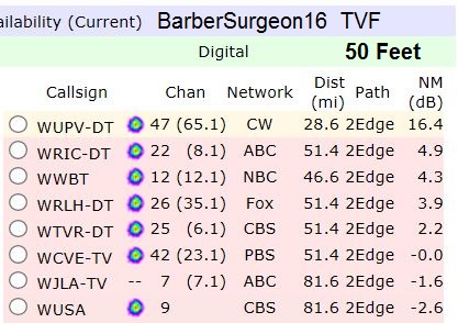

Please Advise: Weak Signal, even woth trying more?
Friend has moved location and previously had dish. Was interested in OTA, so I said I would bring over my basic Hoverman-Grey and my cheapy amp to see if we could get anything. Ran from existing roof mount, @25ft above ground.
No channels came up on search. Antenna pointed to try to pull in Fox and At least CW between 250* and 260*.
Location is at bottom of a hill, and there are trees. I figured if we could at least get CW, I might try a different amp or add a reflector to my antenna to try to pull is something additional. At my house I can get all the stations out of richmond, with an attic mount my line of sight is much better, and better signal over all.
So here's the location search results:
http://www.tvfool.com/?option=com_wr...e6a4f472e6c14d
Was thinking of a Channelmaster Signal amp, possibly could get another 5 feet up with another mast and mount improvements. When Analog broadcast was OTA, they got most of the richmond networks at this location.
If nothing I do is going to get a usable signal here, I'd rather not waste time and money for no return.

Your TV Fool Plot is resolved only to the block level. It's probably reasonably accurate, but maybe not. For better accuracy make another plot using the following directions and post it: http://forum.tvfool.com/showthread.php?t=14508
The antenna recommendations are all good.

Thanks for all the help. I'll see if I can refine the location. I think the trees are the biggest issue. There are less trees toward the DC stations, and I Might schlep the HG back over and rig a reflector to see what happens.
Realistically is anyone getting reliable reception from stations in grey fields in the -5 to -10dbm range??? I guess that's the key question as to if it's worth moving forward.

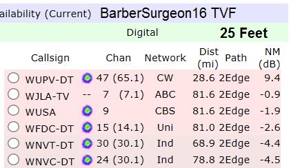

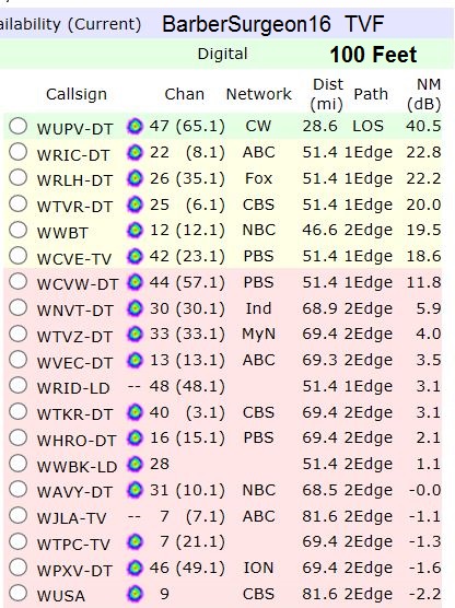

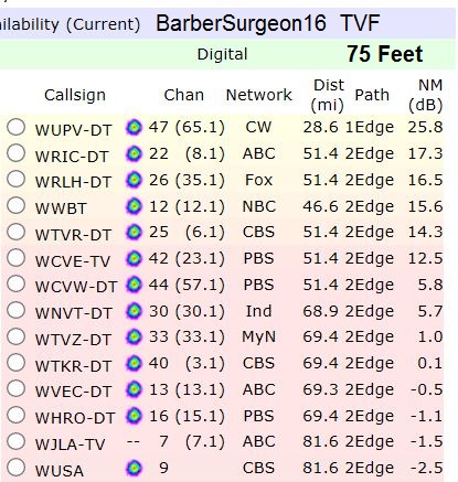

Using the TVFool Interactive map, I tried different antenna heights. Please keep in mind that the computer simulation doesn't know about the trees and other ground clutter, it primarily uses elevation.
The Richmond channels get a lot better with the increased height, but 7 and 9 from the north stay about the same because they are blocked by the curvature of the earth.

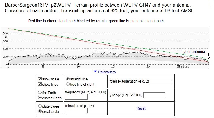

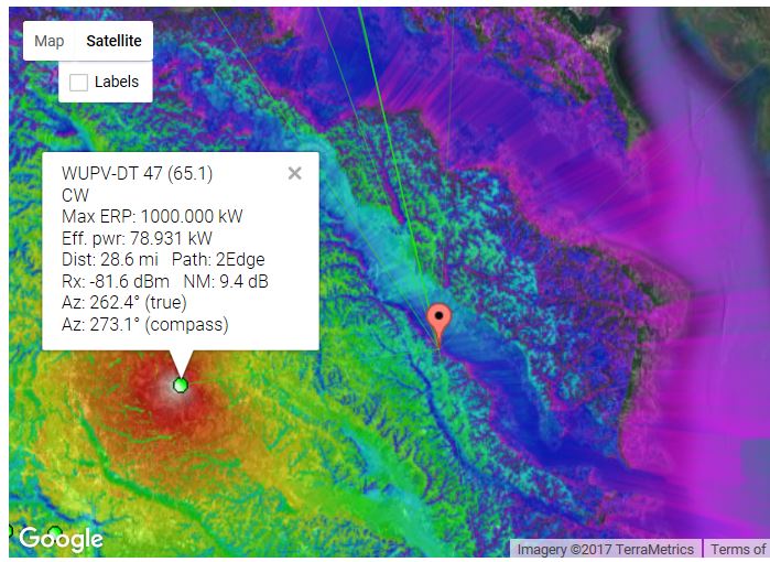

Here you can see why a little more antenna elevation helps with the signals from the west.

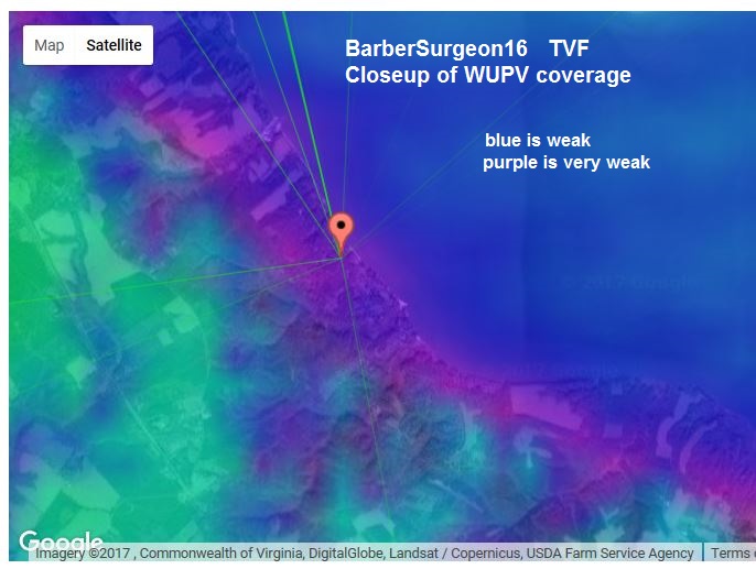

Here is the coverage for WUPV. Note that only 78 kW out of 1000 kW ERP gets to your antenna because of the directional transmitting antenna pattern:

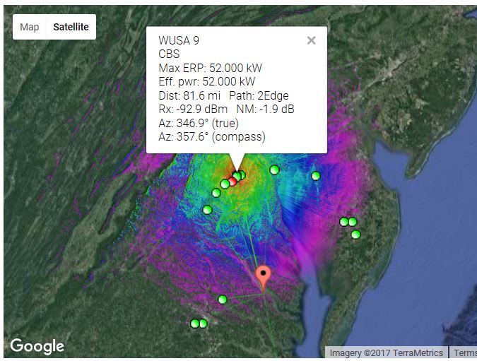

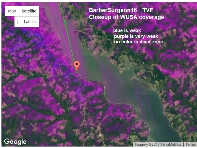

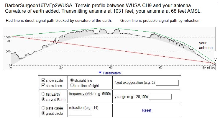

The curvature of the earth blocks the WUSA signal. You can see why increasing the antenna height doesn't make much difference.
You can see you are on the extreme fringe of WUSA coverage:

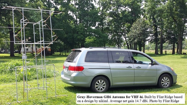

Your G-H antenna doesn't have enough gain for WUTV.
It also doesn't have enough gain for VHF-High channel 12, even with NARODs, unless you built a VHF G-H like this:

I think you must mean -5 to -10 dB Noise Margin (NM) range. Signals that are -5 to -10 dBm are extremely strong; strong enough to overload a tuner.
If an antenna is in the clear, it is possible to receive signals as weak as -15 dB NM. It is not possible to receive signals any weaker than NM -15 dB, because they are below the Thermal Noise Floor at -106 dBm. If you are able to receive signals weaker than -15 dB NM, either the TVFool report is wrong or the signals have been enhanced by Tropospheric Propagation.
