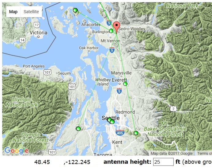

Currently, I have the 7698 mounted in the attic, pointed towards Bremerton and Seattle. I get KCPQ 13 Fox real ch. 13 perfectly, KING 5 NBC real ch.48 all the time, KOMO 4 real ch. 38 ABC most of the time, KIRO 7 CBS real ch.39 almost never. I also get 11,16, and some 20's and 33's. I know there is a KIRO 7 Transmitter only 4 miles from me, but a different direction. Is there a way to get KOMO 4 (real ch.38) and the KIRO station near me better? Would the DB8e and a separate VHF antenna work better for me. Thanks for your time.

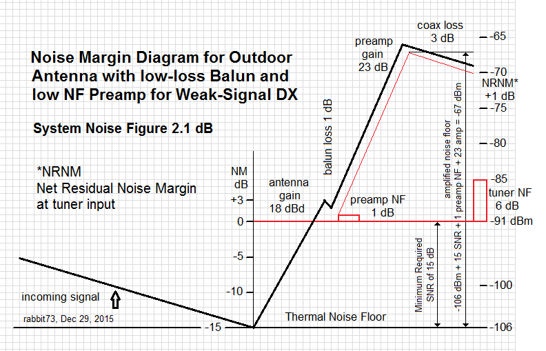

Your channels are pretty weak for an attic antenna. Signal loss in an attic is difficult to predict.
Early on, I picked up a Winegard LNA-200, (which made things worse).
That's odd; it should have helped.
KING 5 NBC real ch.48 all the time....KOMO 4 real ch. 38 ABC most of the time
It is difficult to receive signals with a NM of less than -10 dB. If you are able to receive signals with a NM less than -10 dB, you have an excellent antenna system, or the tvfool report is wrong (often possible with weak signals), or they have been enhanced by Tropospheric Propagation, which is common at this time of year.

That one, KIRO real channel 28, should be easy. The antenna must be aimed at 285 degrees magnetic. The 7698 antenna is very directional.

The hill is blocking the KIRO 28 signal:
so the signal gets weaker as you go down the hill:
Old 19-Aug-2017, 1:31 AM   #7
The Seattle signals have an even more difficult path:
and there is no coverage shown in your area:
