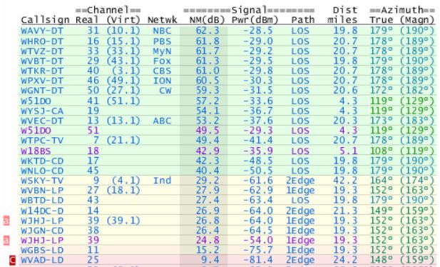

TvFool report is available here. http://www.tvfool.com/?option=com_wr...e6a42cb691d277
I recently cut cord and currently using ClearStream 4V antenna. This antenna comes with VHF channels also. I live in the ground floor of an apartment and the antenna is placed in patio. I get pretty good reception of all the UHF channels except following.
1. KPIX ( 5.1 ) - Works most of the time.
2. ABC Channel ( 7.1 ) - VHF . Spotty reception works ok some times.
3. PBS ( 9.1 ) - Spotty reception works ok some times.
Is there any thing which I can do? The cable length is around 20 feet. I used
Winegard LNA-200 Boost XT Digital HDTV Preamplifier also. It doesn't make much difference.
Any help appreciated?. I am open using one more VHF antenna if it improves reception.

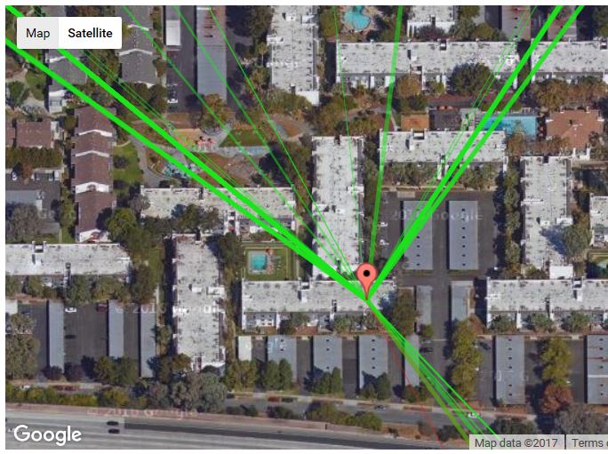

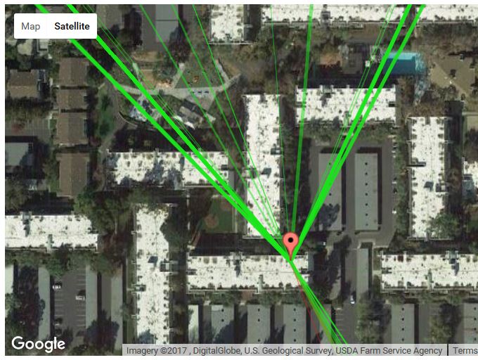

If you are willing, you can send me the coordinates of your antenna so that I can see the green signal lines on the satellite view.
There are two views available, bird's eye and vertical. The cursor shifts a little when you change from one to the other. You can move the cursor by drag and drop; the coordinates below the map will change as you move the cursor.
You can do the map here:

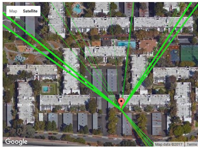

I do see a building in the signal path, which would account for the different azimuth. The signals try to sneak around and through as best they can.

I'm using a GE attic antenna indoors on the ground floor with buildings and trees in the signal path. My report is similar to yours but of course the signals are much weaker inside. I have a VHF-High channel 13 that has a listed strength almost as strong as the UHF channels, but the GE antenna has much less gain for VHF because it is just a folded dipole for VHF-High; UHF is a 4-element beam.

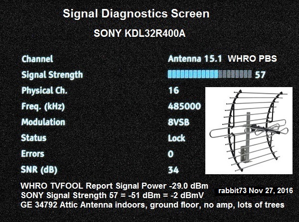

I use the Diagnostics Screen of my Sony to monitor signal strength, SNR, and uncorrected errors. Notes and picture of antenna added.

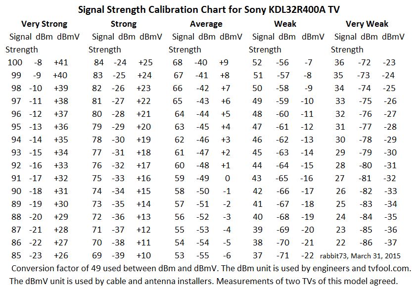

I calibrated the signal strength scale with my signal level meter, so I know what the readings mean.
