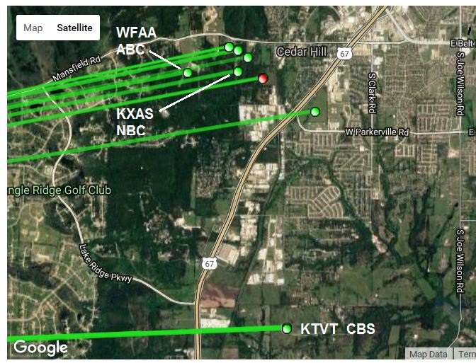

I need help with an antenna. I bought a channel master CM-3010HD STEALTHtenna 50 and it's working good for most of my locals except CBS. I get pixelation and complete signal loss from time to time. I am splitting the signal to two tv's and I'm using a PCT-MA2-4P AMP.
Here's my signal analysis. http://www.tvfool.com/?option=com_wr...e6a4a6bf1b8d1d
Thanks for any help you can provide.

Old 17-Mar-2017, 4:10 PM   #6
Originally Posted by gaw View Post
Antenna is in the attic.
Coax runs are 50'
Yes...there are some trees that might be in the direct path.
Just curious why ABC & NBC never pixelate or lose signal?
The signal path for CBS is different, because its transmitter is in a different location.

Old 17-Mar-2017, 5:29 PM   #7
I've run into the exact issue even when the problem transmitter is on the same tower and even when it emanates from the same antenna as a station that is not having problems. Every frequency is affected differently ever-so-slightly by impairments in a given path.
The final few hundred (or dozen) feet can make or break reception. It's usually a mistake to assume that ALL of the incoming signals will arrive perfectly in the particular spot that looked convenient for the placement of a receiving antenna.
