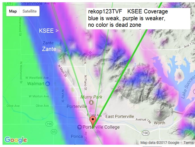

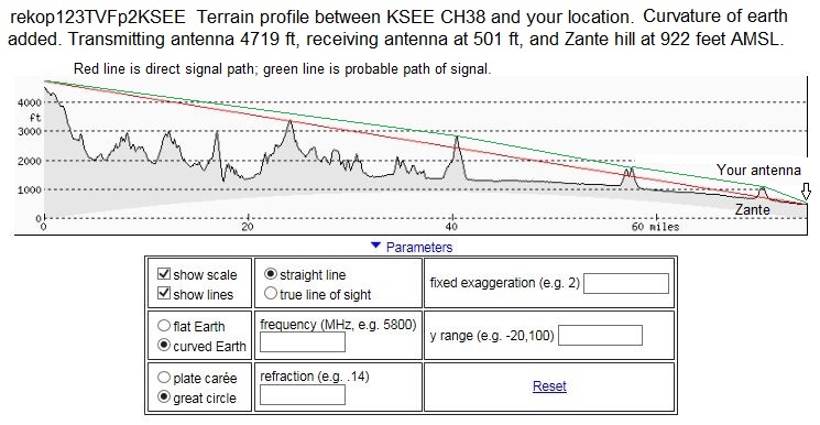

KSEE NBC will be the most difficult. At 74.5 miles away, the curvature of the earth will interfere with the signal
http://www.rabbitears.info/market.ph...&callsign=ksee
http://www.tvfool.com/?option=com_wr...ALLTV%26n%3d15
The last hill on the path near Zante causes the most harm to the KSEE signal.

Old 2-Mar-2017, 10:21 PM   #5
Here is a coverage map for KSEE:
and here is a terrain profile for KSEE using different software:

Old 2-Mar-2017, 11:04 PM   #6
