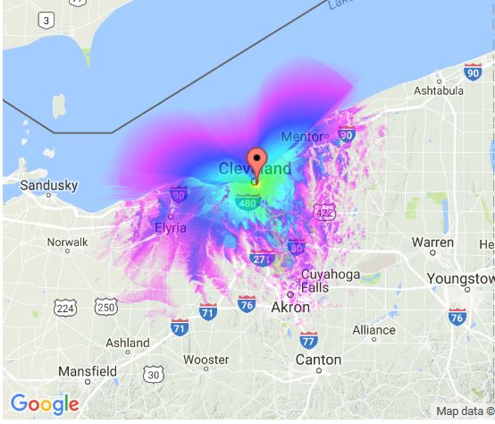

WQDI and WEKA are too weak to reach your location. Take a look at the coverage maps:
http://www.tvfool.com/?option=com_wr...&q=call%3dwqdi
http://www.tvfool.com/?option=com_wr...&q=call%3dweka
WQDI is listed using the tvfool interactive map browser
but it is too far down the list to show on the radar plot from the browser
http://www.tvfool.com/?option=com_wr...e6a4f0d231b2b5

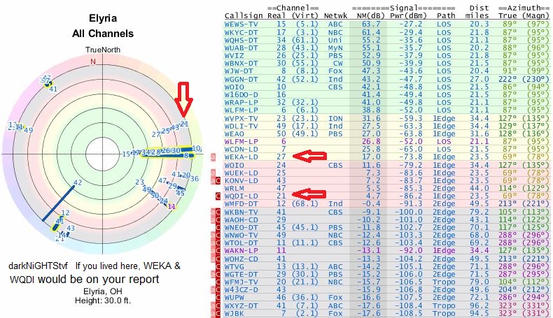

IF you lived in Elyria, WQDI and WEKA would show on the report, which proves they are in the Database:
http://www.tvfool.com/?option=com_wr...e6a48fa361e0b8
