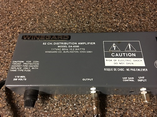

I found the amplifier I tried, I was not certain how to connect to it. There are UHF and VHF inputs, but I am using a single coax from the antenna, what is the correct way to hook it up?
Thanks
Rich
Peoples16127 is offline   Reply With Quote
Old 28-Feb-2017, 1:33 AM   #11

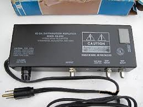

I couldn't find any manual for that amp, but I did find an old photo that shows the VHF input at the right end that you did not include in your photo.
Your strongest channels are UHF, so just connect the antenna coax to the UHF input.
If you also want to try for the weak VHF channels, then connect the antenna coax to the common port of a UVSJ, connect the VHF port of the UVSJ to the VHF input of the amp, and connect the UHF port of the UVSJ to the UHF input of the amp.

You are correct, I cut off the right hand side of the amp when I took the picture.
I had never heard of a UVSJ, I tried to use a normal signal splitter, maybe that part of my problem.

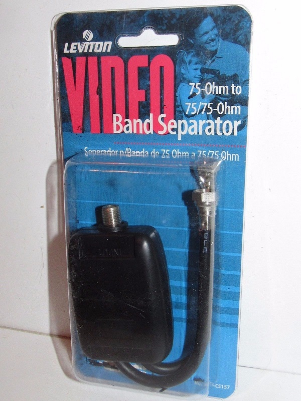

Is this the correct splitter for a single antenna cable to an amp with VHF and UHF inputs?
http://www.ebay.com/itm/LEVITON-VHF-...cAAOSwA3dYcbd1
Thanks
Rich
Old 1-Mar-2017, 5:34 PM   #14
That would probably work OK. It has two coax leads to connect to the amp. A more conventional UVSJ has a metal case for shielding, but would require two jumper coax leads.
