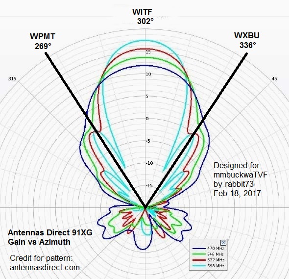

This might work, but you would need to add a VHF antenna for VHF-High and FM. You could use the 7694 as a test for that and combine it with the 91XG (or HDB91X) with a UVSJ:

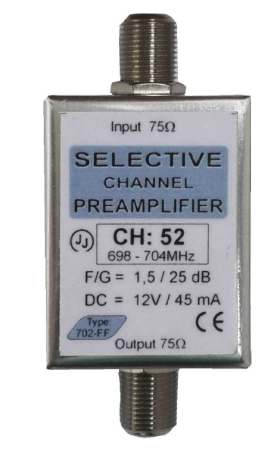

Another approach is a selective amplifier for ch 36:
http://www.ebay.com/itm/UHF-selectiv...item1c6483bd0a
