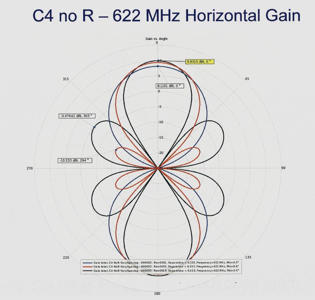

The following graphs were done by our design engineer as part of project to see of the horizontal spacing could be reduced so that it's overall physical size could be made smaller and thus be attractive to more retail sales partners.
The black trace is the one that is the current spacing in both plots. For the purpose of this illustration, ignore the other traces.
With Reflectors
No Reflectors
