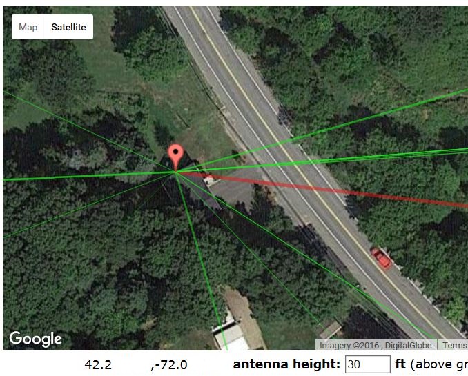

42._____,-72.____ is the location of my antenna. I didn't see a way to share the google map directly. It's about 30ft off the ground above the roof line.
I am using a Mohu Sky HD for a UFH antenna. Yes it's one of those all in one antennas that comes with the little power block and has the pre-amp built in. Until this NBC change this antenna has done really really well and my wife loved the size of it. She didn't want one of the typical style ones up on the roof and this worked great so I didn't argue.
Yes I put it on a rotator.
Trees are mostly on the western part of the house. All other sides have a good distance between any trees.

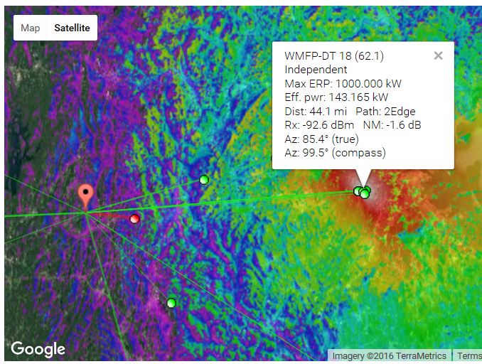

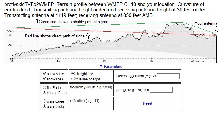

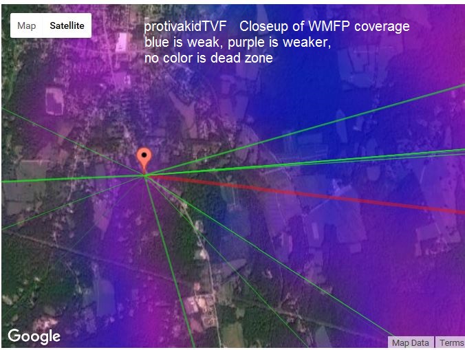

Ah, yes; I see the trees to the west.
You are on the extreme fringe of coverage for WMFP. Note that only 143 kW out of 1000 kW ERP is sent in your direction:
You would need a high gain UHF antenna and a preamp for any chance at that.
It would probably help to tilt the front of the antenna up. The Antennas Direct 91XG and the Solid Signal HDB91X have the tilt feature. The DB8E has more gain for channel 18 with both panels aimed in the same direction, but it doesn't have a tilt adjustment; it would be a custom mod.

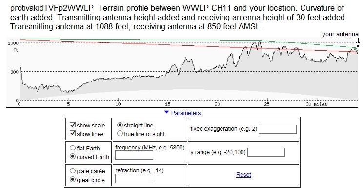

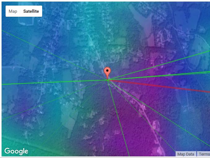

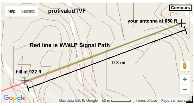

Contrary to the results I can NOT get WWLP at my current height even if I point my AntennaCraft (Y5-7-13) right toward it. There is also a hill directly that way. Normally I use this VHF only antenna for WNAC and keep it aimed that way.
Yes, you would think so. The tvfool report knows about the hill, but it doesn't know about the trees in the WWLP signal path. Trees block TV signals.
That little hill only 0.3 mi away is a problem.
An MCM 30-2476 with the front end tilted up and a preamp might pick it up.

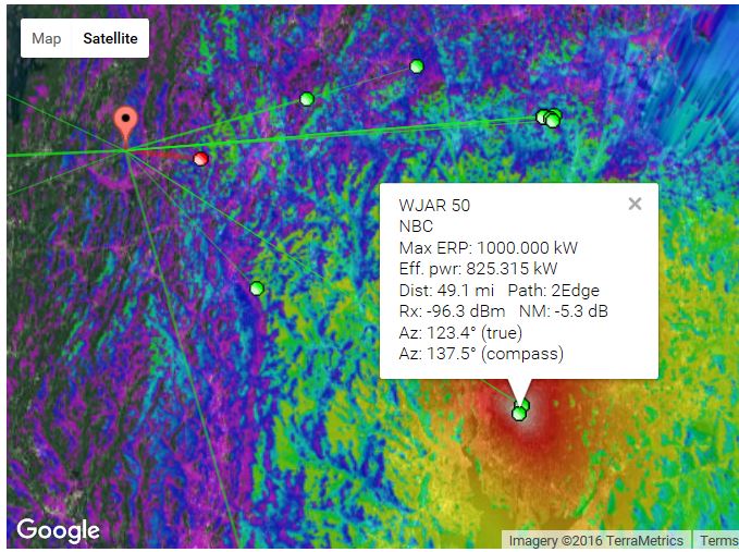

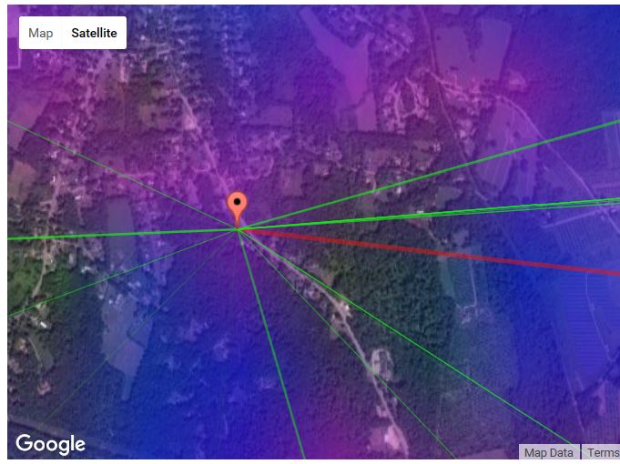

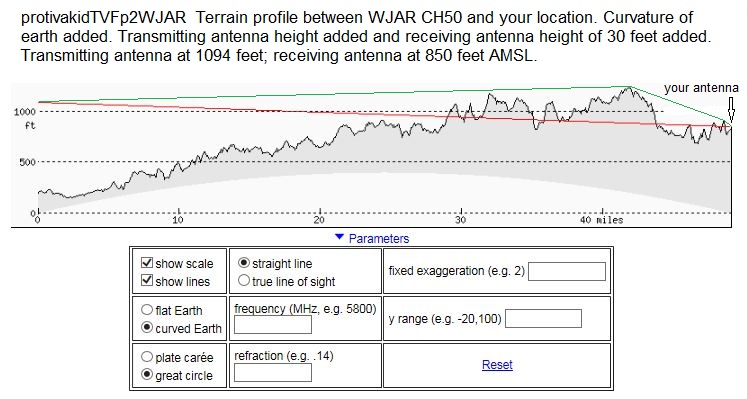

The only other NBC station that I can sometimes get is WJAR and that requires aiming my UHF antenna in the direction of WNAC and even then the signal is not consistent. I also lose the Boston stations like WCVB.
WJAR coverage:
Think I will need to add a second UHF antenna and rig something up in the hopes of getting WJAR?
An Antennas Direct 91XG or a Solid Signal HDB91X with the front end tilted up and a preamp might work.
