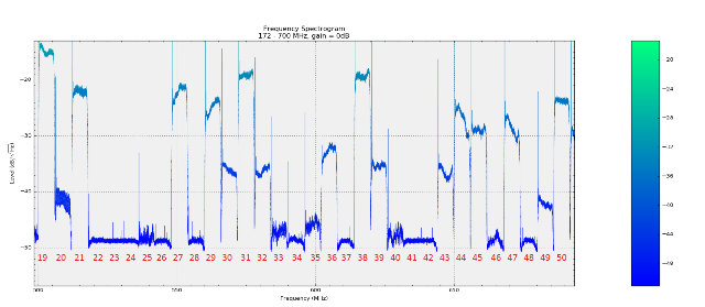

I followed the lead of Pete Higgins and set up a low cost RTLSDR spectrum analyzer.
For more info, see this thread in the Hi-Def forum:
http://www.highdefforum.com/local-hd...r-10-00-a.html
It cost me less than $10 in hardware, free software and it rivals some of the screenshots of spectrum analyzers I have seen around the different forums:
Thanks for reading, I am just scratching the surface, but already I see that is very useful and cost 99% less than a professional analyzer !

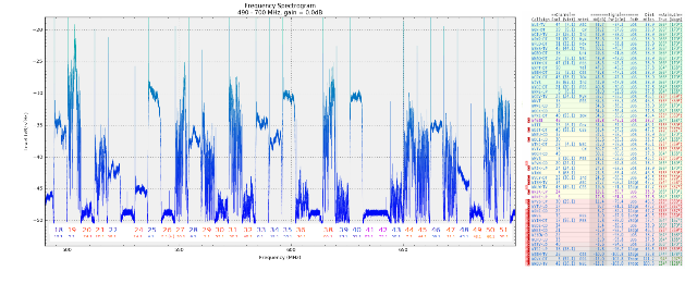

Well, it's been almost a year and I have made a lot of spectrum saves, done a lot of overlays etc... It's really a great tool. I will admit that it does needs a fairly powerful PC. The one I run is a "hot rodded" HP with an i7 4770 and Intel SSD, 16 GB RAM, Windows 10 Pro. Even with that it tends to take a fairly long time to analyze the spectrum. Several minutes anyhow.
I used it so much trying to analyze my two antenna set-up and got the antennas pointed to optimum that I finally unhooked it, no use for it. If need be, I can rerun a cable to the PC for signal analysis in the future.
