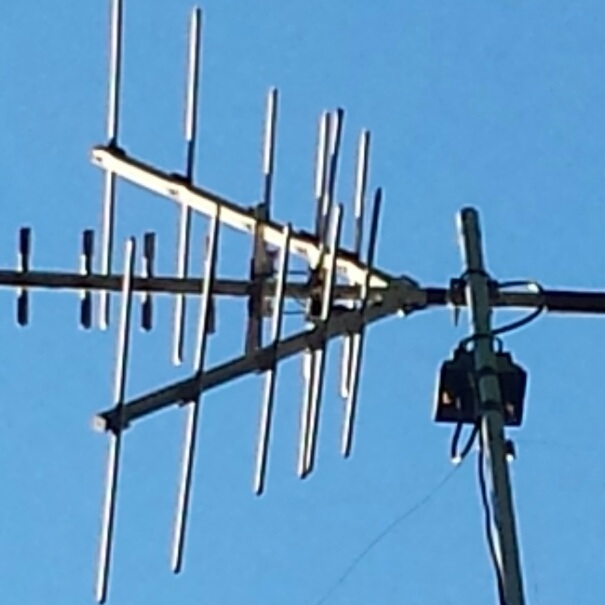

I am 45 miles north of the madison wi transmitters and have occasional drop outs and pixilation mainly when it is windy.
I have trees 50 feet from the antenna and terrain about 10 miles away that prevents line of site to the stations.
http://www.tvfool.com/?option=com_wr...e2cbe4cc6c2618
I modified my combo antenna by cutting off the VHF portion and kept the yagi part. I am using a channel master 7777 amp and normally have awesome reception.
The problem comes when it is windy in the summer and the trees move around and then the drop outs seem too occur. I thought it might be cell phone interference because there is a tower 1/8 mile away so I grounded the mast and coax shielding to a 5 foot copper rod.
The mast is secured with guy wires and doesn't move in the wind.
Is there a better antenna I can use to keep the solid signal when the wind blows?
Thanks in advance,
Dan

The combination of non-LOS (weak UHF), trees, wet and/or windy weather are common reasons for reception failure. Replacing the antenna can only offer a small margin for improvement. Replacing the antenna's signal path with one not conducive to signal interruption is what's actually required if you want to ensure reliable reception.
Here are three ideas, all guaranteed to work, nothing else has that guarantee.

Problem is not the antenna, the signal getting to it is. Bigger antenna will get you more gain, but it will still have drop outs in summer wind.

Based on my experience, and I've spent a LOT of time and effort trying to "fix" tree problems, I've concluded that it's going to be pot luck. I've not had any particular level of greater or lesser success when changing types of antennas. Usually, a simple movement of the antenna will "fix" a problem channel temporarily but it often breaks a different one now or when the trees grow or the wind blows from a different direction, etc.
