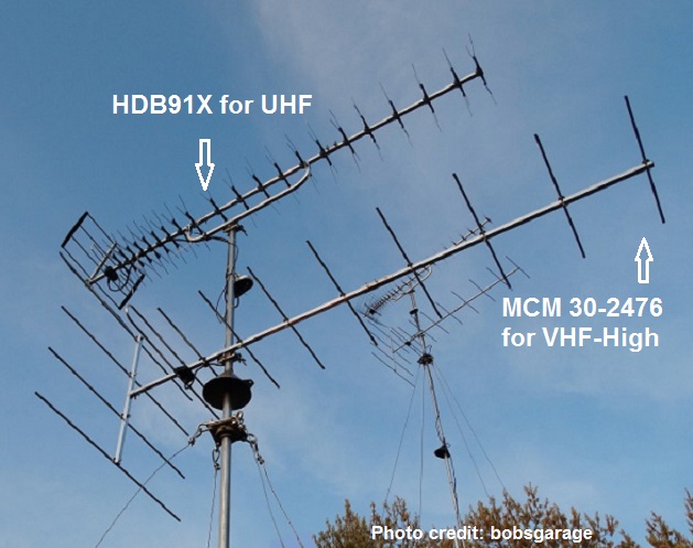

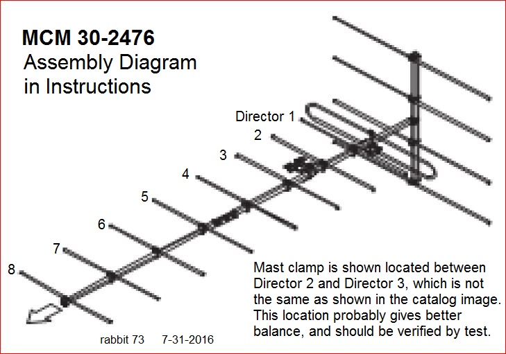

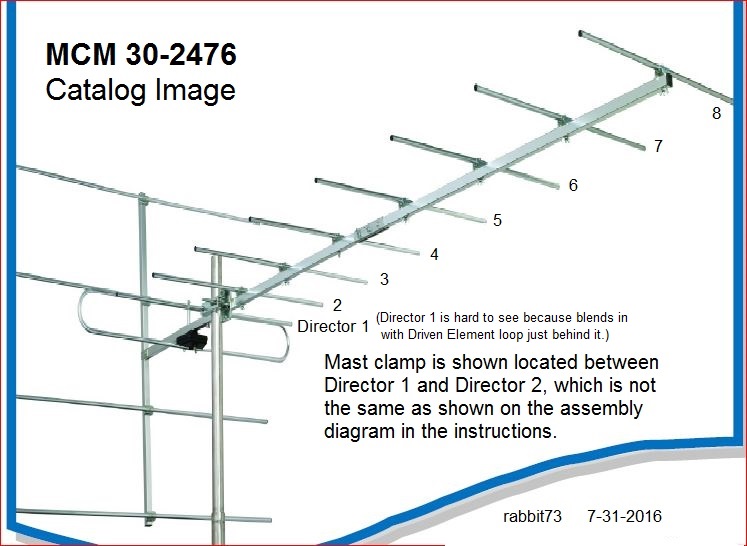

I suggest an MCM 30-2476 VHF-High antenna aimed at 137 degrees magnetic for
KSBW 8 NBC and ABC
http://www.rabbitears.info/market.ph...&callsign=ksbw
and
KCBA 13 Fox
KION CBS 32, NM -18.8 dB, is too weak for reliable reception
http://www.mcmelectronics.com/produc...-2476-/30-2476
The 30-2476 is inexpensive, has poor assembly instructions, but usually performs well.
It looks like this up in the air:
Try it without a preamp first.

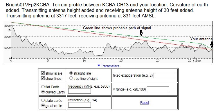

This is the KCBA profile. Note that only about 10% of the 19.750 kW of the transmitted ERP reaches your location because of the directional pattern of the transmitting antenna.
http://www.tvfool.com/?option=com_wr...dALLTV%26n%3d6
KCBA terrain profile using different software:

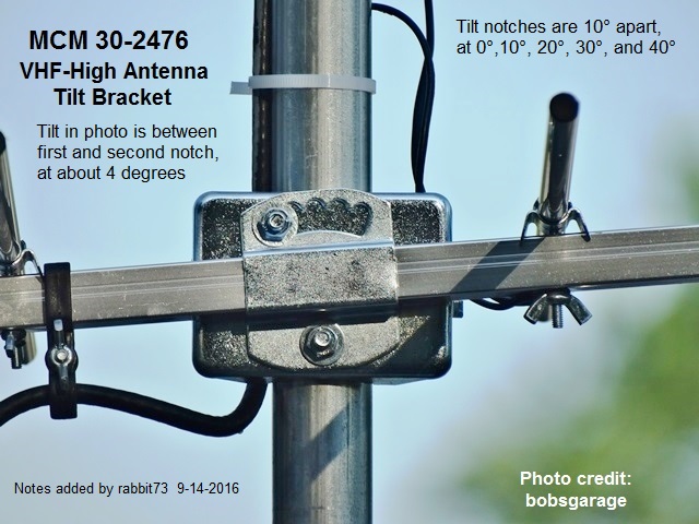

The MCM 30-2476 has a tilt feature. It might be helpful to tilt the front of the antenna up to catch the signals from the mountain peak.
