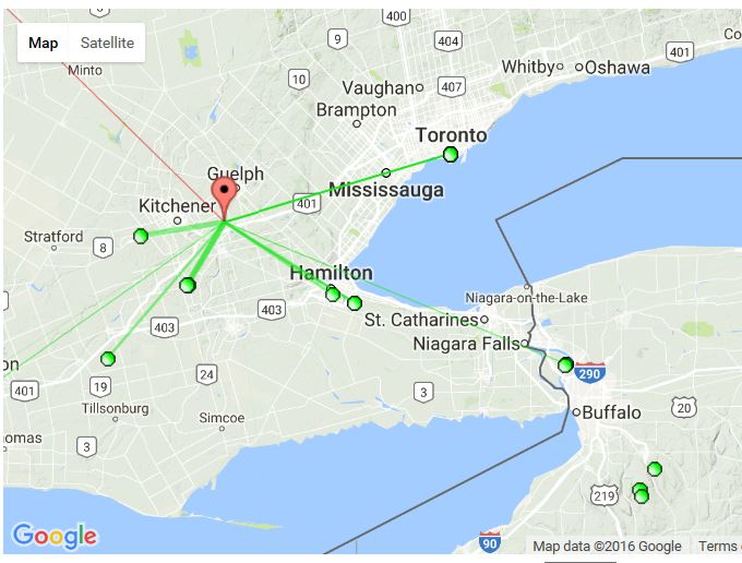

This is my location
http://www.tvfool.com/?option=com_wr...e2cb7f4f36ea8b

You have channels in different directions. What channels are most important to you?

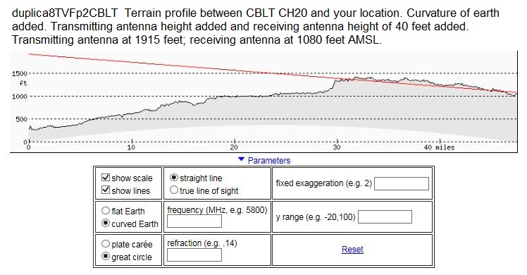

5.1 Intermittent
CBLT-DT CBC listed under Pending on report as real 20, virtual 20.1; actually real 20, virtual 5.1
https://en.wikipedia.org/wiki/CBLT-DT
NM 10.2 dB, 2Edge, 47.6 mi, 73 deg true
Is that the escarpment in the path of your signal?

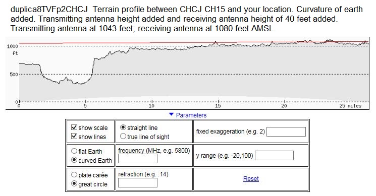

You have a difficult location for TV reception because the channels you want are in 3 different directions. The 4-bay section aimed west seems to be doing OK. The 4-bay section aimed SE isn't doing very well because there is an escarpment in that direction too, and the SE aim is wrong for CBLT in Toronto.
35.1 Intermittent
CHCJ CTV Two real 35, virtual 35.1
https://en.wikipedia.org/wiki/CKVR-DT
NM 12.7 dB, 2Edge, 26.4 mi, 124 deg t[rue

I'm not sure. The best setup for reception would be a separate antenna and preamp for each direction, but you probably wouldn't want to do that because it would be very inconvenient with 3 TVs; it would need switches and rescanning.
I can suggest some tests you can make to see if it is even possible to get good reception from 73 and 122 degrees true. Try aiming both panels at 83 degrees magnetic and see what you get from Toronto. Then try aiming both panels SE at 132 degrees magnetic to see if the escarpment is no longer a problem.
If you then get good reception from both of those problem directions, you will need to decide which channels are most important to you and how much trouble and expense you are willing to do.

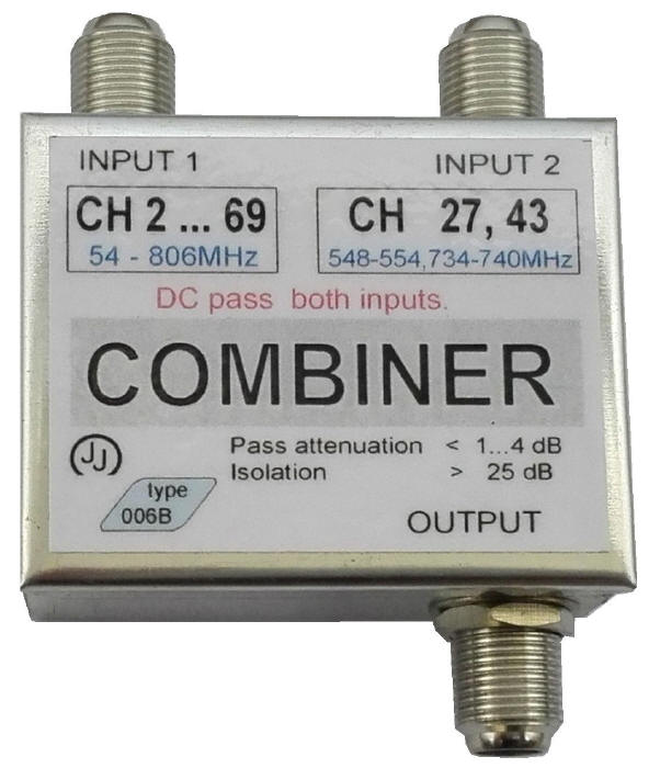

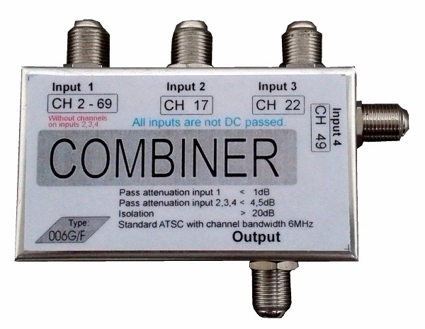

5. Two or three antennas combined into one coax with custom combiners from Tin Lee Electronics (expensive) or from Jan Jenca (much less expensive).
http://www.tinlee.com/index.php
http://www.tinlee.com/PDF/AC7-custom...kup%20Info.pdf
