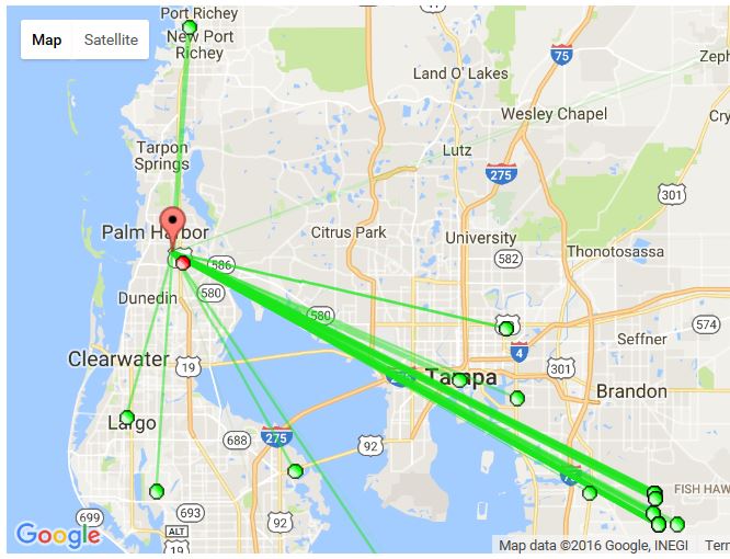

You can see the sub channels if you click on the callsigns in this list for your zip code.

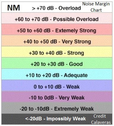

Thanks for the amp info. What I'm concerned about is overload; there is such a thing as too much amplification.
WMOR has a Noise Margin of 58.0 dB for an antenna mounted in the clear. If you add the HDB4X antenna gain of 12 dB (they say max of 14.2 dB) you are up to 70.0 dB NM, which is on the edge of overload.
Looking at it using the signal power, WMOR is -32.8 dBm.
-32.8 dBm + 12 dB ant gain + 20 dB amp gain = -0.8 dBm, which is tuner overload even when allowing for the coax loss after the amp.
It might be even worse than that, because the 1byone website says 32 dB gain, but they don't state the conditions:
https://www.1byone.com/TV-Accessorie...nna/OUS00-0683
ATSC Recommended Practice:
5.1 Sensitivity
5.2 Multi-Signal Overload
You have more than one high-level signal.
When you have partial overload, it is possible to receive your strongest signals, but the weaker signals (like NBC) become damaged by IMD (Intermodulation Distortion) which produces spurious signals which raise the noise floor and reduce the SNR of the weak signals to less than the minimum required 15 dB for reception. NBC is listed as 6.4 dB weaker than WMOR, but the difference is greater than that because your present antenna isn't very efficient for NBC.

Thanks for the very detailed post showing numbers. Lot for me to take (I'm a coder so I love geeky details).
So, based on your post, and studying other links/docs, I think I want to achieve a NM of 0 at least (preferably 5 or 10 NM, to give myself buffer, otherwise I'd probably have frustrating viewing experience having signal drop below threshold quite often due to random events).
Antennas comes with gain that will add to the NM (says here https://www.tvfool.com/index.php?opt...57#how_to_read that antenna is the only one that I can really add to NM?), and based on your post, it sounds like I don't want antennas with too much gain - because it seems most of the stations I want already have NM numbers of around 55? (adding 15 NM or so would put it into overload territory). How much gain would I get from the HD7694P?
And then signal power is another thing. Sounds like I want to aim for -5 dBm or less. Anything over -5 dBm would also be overload. So, if I remove the powered amplifier, it'll eliminate about 20 db, bringing me out of overload territory. Hope I understand this correctly.
But removing powered amplifier would cause me to lose NBC with my current antenna; we've already established that my current antenna is not effective for NBC, so the new antenna would most likely solve this.
Thanks for the quick education!
