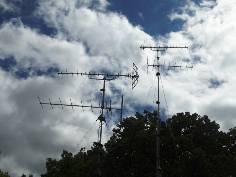

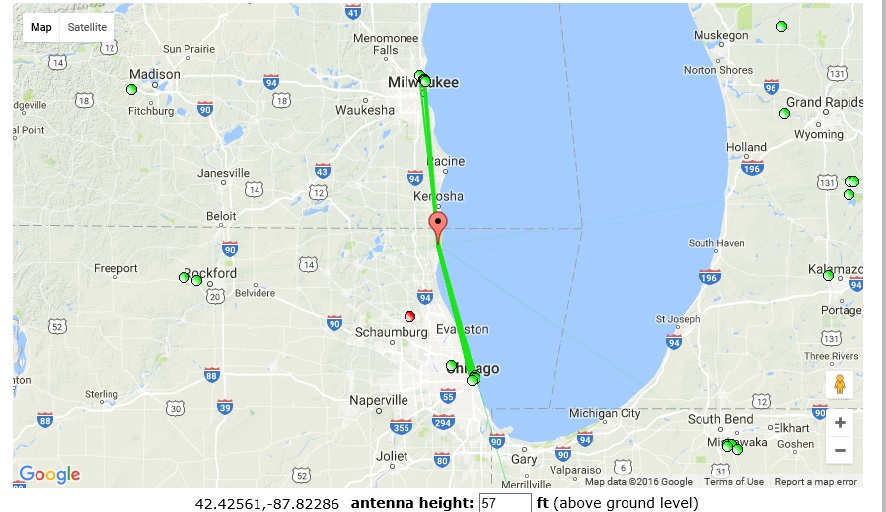

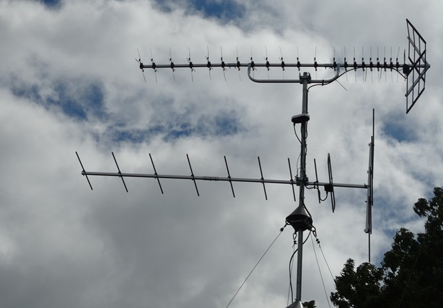

30-2476 seem good to me.
You said you took down the antennas, so there must not be any physical interference.
I have two of the aforementioned antennas. One is pointed at Milwaukee 49 miles north and one is pointed to Chicago 40 miles south. Both cover each market's only VHF station. Chicago has 2.1 on real ch 12 and Milwaukee has 10.1-4 on real ch 8.
In both cases reception is excellent until I combine the arrays, then I get some reception issues.
I have trees, but no major hills in the LOS for both stations.
Check the balun. The new style baluns can break easily.

I have my "south array" that points to Chicago with a 91XG 5 feet above the 30-2476 57' AGL. They are combined by an RCA PREAMP1. It is between the two antennas on both arrays.
The RG 6 is about 75' to the combiner. Alternatively, an additional 6 feet to back of the TV when hooked directly to the TV. I also have a network that distributes it through the house which adds a lot of legs to the system, which is mainly why I used the preamp I chose. Plus, that preamp is a combiner, kills two birds with one stone.

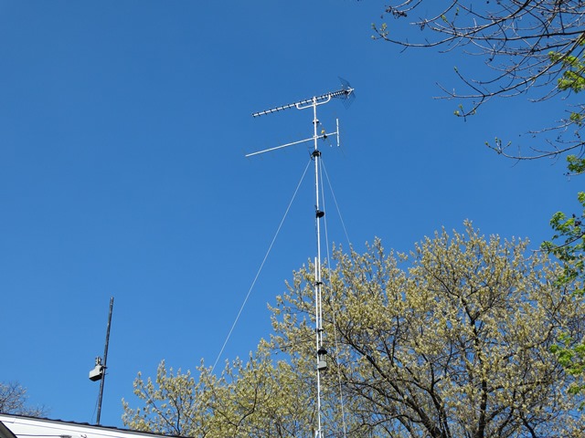

South Pointed Array:
My North pointing array is about 30' AGL and has an HDB91X above a 30-2476. They are also combined by an RCA PREAMP1. The RG-6 is about 45' to the indoor combiner, alternatively, an additional 6 feet to back of the TV when hooked directly to the TV. Sometimes I unhook the network and experiment with my TV in my man cave. That TV has 2 RF inputs.
North pointing array:
Both antennas are aimed correctly in the following pic. They both have rotators, which I found to be indispensable for aiming.
For size & height comparison:
File Type: jpg 2016-05-19 Antennas Finished 91XG & 30 2476 -20 resizes.jpg (135.8 KB, 3916 views)

Nice setup bob.
You have two different antennas on each mast.
Just wondering, why wouldn't you put the same antenna on each mast?
newmguy is offline   Reply With Quote
Old 7-Aug-2016, 4:05 AM   #18
bobsgarage
Antenna Enthusiast
bobsgarage's Avatar
Join Date: Mar 2016
Location: Beach Park IL
Posts: 319
Originally Posted by newmguy View Post
Nice setup bob.
Good Question.
I started with the HDB91X. I combined it with a Radio Shack VU210XR.The mast is 35' above the roof peak. I found it to be an OK antenna until I barely tightened the coax to the balun and the fitting broke off of the board in the balun. I decided I wouldn't put that antenna up high where I can't get to it.
I got the idea that the 91 XG would be better quality and should go up the 35' mast and use the HBD91X on a lower mast where I can get to it if something breaks.
If I had to do it all over again, I would've bought 2 Winegard HD7698P's and put them on the same mast, but I am happy with what I have.
I almost did but 2 7698's but I needed a lot of height and I felt 2 7698's on the same mast that high up could cause wind worthiness problems, since they are fairly large.
The only drawback is my "poor mans tower" might appear gaudy to some that actually notice.

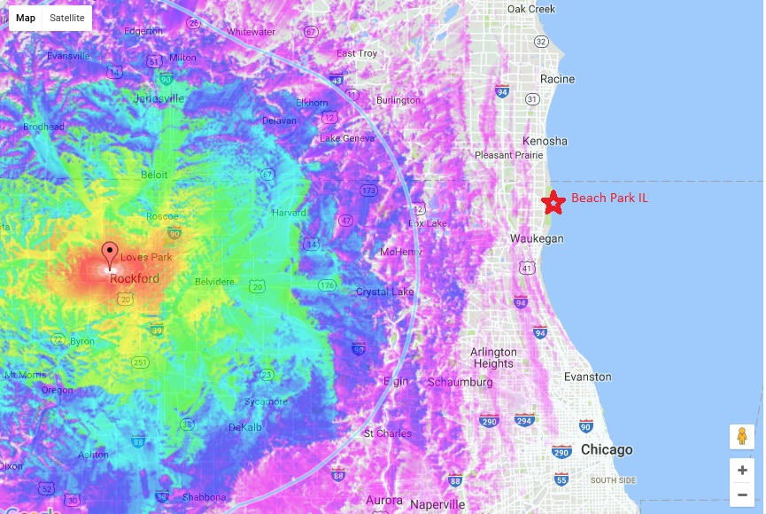

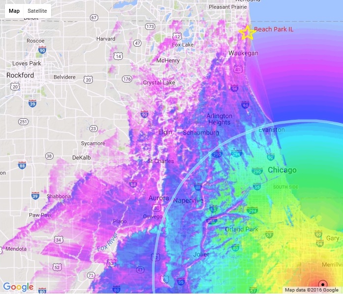

Well, That is the embarrassing part of my set-up. I am stuck with a 70 mile radius for reception and too much work to not have been able to get more.
All the stations that I should get, I do get (Chicago-Milwaukee):
Strangely, TV Fool shows Gary, Indiana shows at the same distance, but it at least 10 miles more and I get that well too.
The farthest station I get is PBS WYIN in Indiana 77 miles, but it is as easy as it gets, across the Lake front with no obstructions:
I really have issues getting Rockford 69.7 miles away to my west, but it looks as if I may have terrain blocking me. I don't think I've ever gotten Rockford and if I wanted it, I would need a much higher set-up. I say that because if I tell the TV Fool Interactive map I have a 300' AGL antenna I see a LOS to Rockford.
57' AGL to Rockford:
Across Lake Michigan are several stations 100+ miles, but I have too many tall trees to my east. I gave up on that this summer but I will retry this winter after the leaves have fallen.
So in reality, I wont get anything over and above what my TV Fool report says I can get.
