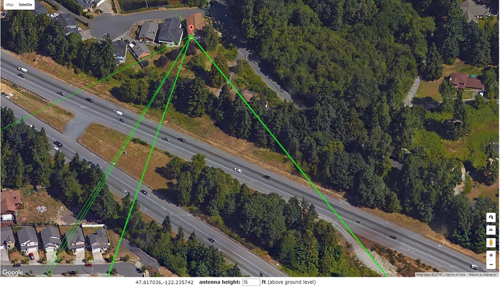

Connection is especially good when I'm touching the antenna but as soon as I'm down from the roof, the reception started to degrade again.
When your body is near or touching the antenna, it can affect the reception in a negative or positive way. We see this often with indoor antennas too.
The location of the antenna is critical; you need to put it where the signal is strongest, which might not be where you want to mount it.
It was working great for a year or two but lately, the signal it receives was like in and out. I'm guessing the tree across the freeway grew taller and started to block the signal.
Your guess is probably true. Trees do serious harm to TV signals.
Any suggestion on the antenna I can replace it with.
There is no magic antenna that can "see" through trees.

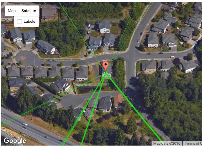

Can you show us a photo of your antenna and a photo of what the tree looks like when your antenna is aimed in that direction?
So will replacing antenna to a better one solve the problem or it's not going to make any different because of the trees? Please advise?
Maybe, but first we need to see your present antenna and it might be necessary to move it, or go higher.
What we would like to know is your exact location by address or coordinates so that we can draw the green signal lines on the satellite image. We don't expect you to give that information in the open forum, but you might be willing to give it in a PM (Private Message).
For example, a house in your area:

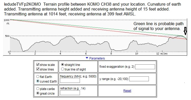

Besides the tree you also have a hill in the signal path.
The transmitter is on the left and your location is on the right.
http://www.tvfool.com/?option=com_wr...ALLTV%26n%3d10

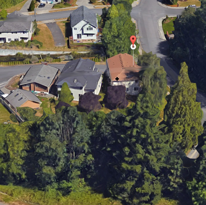

Thanks for the detail explanation. I'm attaching the picture of my place including the location of the antenna. I also PM you my home address just now. FYI, The red dot on the roof is exactly where I placed my outdoor antenna. If you zoom the picture, you can actually see the antenna there. I pretty much used the old dish network pole that was there with the house. I just removed the dish and replaced it with my antenna.
Gosh, its so unfortunate that there's a strong local FM signals that's affecting the TV reception. I noticed it lately, when I watched the local PBS channel at 9-*. The strange thing is channel 11-* for CW is not affected at all.
The trees that blocked most of the signal are the trees across the freeway. Nothing I can do about it I guess.

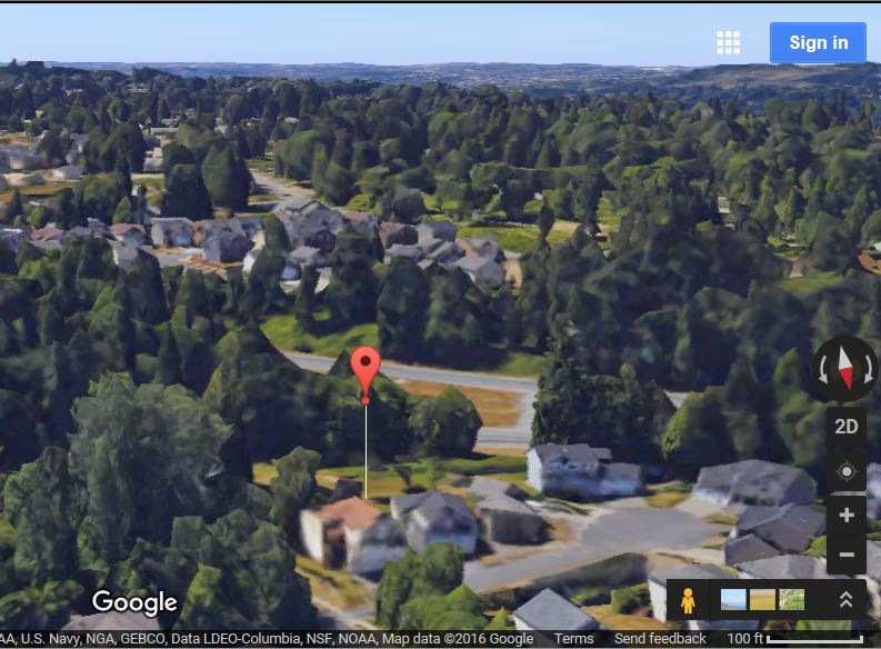

Thank you for your kind words; sometimes I can help and sometimes not. I too get frustrated if I am not able to help.

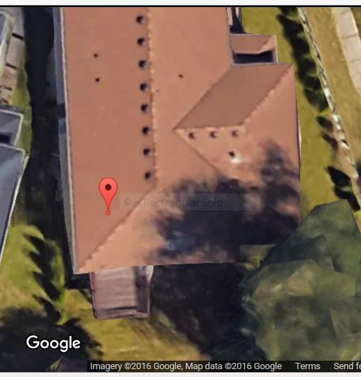

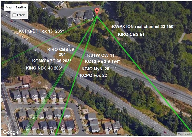

Thanks for the image with the green lines. It does look like the trees might be a problem.
I can't see the antenna or the pole, but I will assume it is where the marker is located.
I see trees across the freeway, trees on your side of the freeway, and trees behind your house. Also, the channels you want are not all in the same direction, so you need more than one clear path through the trees.
Looking SSW:
I think you need to get your antenna higher.
We still don't know what your antenna looks like, so it is impossible to make a suggestion about a better antenna.
Can you show us a picture of your antenna, or as second best maybe give us a link to one that looks like it?

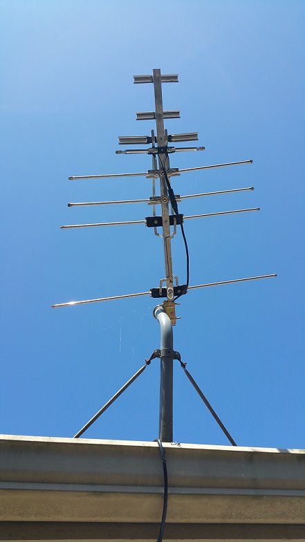

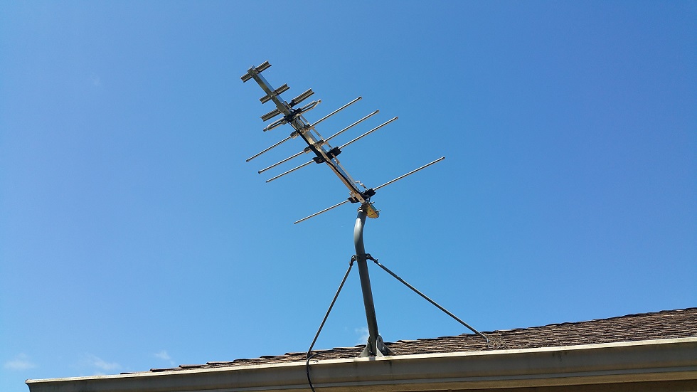

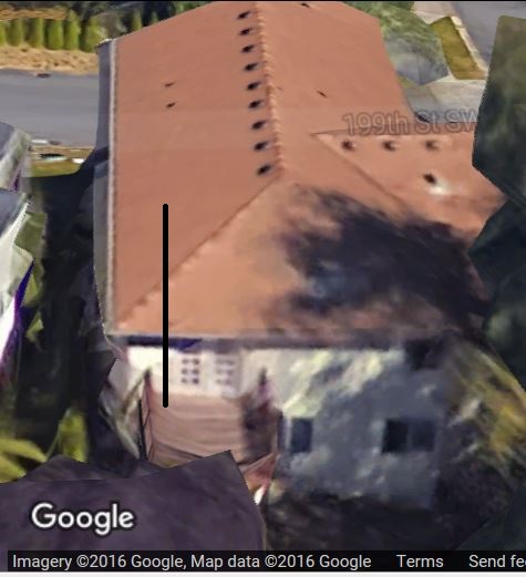

Here is the different angle of the antenna placement. The black cross is where the antenna location on the roof. As you can see, trees in front of the antenna (lower than antenna I think) and another tree behind it and its taller than antenna. But I tried to point the antenna to in between the trees as much as I could.
Here are pictures of the antenna from different angles. As you can see, it sit right on the edge of the roof to make it easier for me to readjust it when I have to.
At the time I purchased it, my research shown that, that antenna is the best antenna in the market and its cheap. I bought it from Radio Shack and I think it's an RCA antenna. Its only like 30 something bucks. Hope the pictures help a bit.

Thanks for the excellent photos. Your antenna is an RCA ANT751 for UHF and VHF-High channels, which is what you have.
If you want to upgrade, you might consider the Winegard HD7694P aimed at 187 degrees magnetic.
But first, you might want to raise your RCA antenna by adding a 5 ft mast to the satellite mount. I wouldn't go any higher, even though the mount has braces.
If you want to try the Winegard HD7694P, I suggest a mast coming up from the deck supported at the base and supported near the roof by a wall bracket. If the antenna doesn't have a clear path there, move it.

I added a terrain profile for KOMO which shows the hill; see post #4.

That mast doesn't look like it's vertical. In fact, in the bottom pic, the camera is almost aligned with the topmost part, where the antenna is connected, but the bottom of the gutter, which is normally flat and horizontal, looks to be very much not square with the camera. Is the antenna horizontal, or nearly so?
tomfoolery is offline   Reply With Quote

tomfoolery, I angle the antenna up a bit like around 10 degree because I was hoping that it can avoid the tree in front a bit. Doesn't look like it's working.

Hi AdTech.
I'm wondering whether you would mind answering one more question. What's typically the size of the pipe that you would suggest that will fit into the mast that's already installed?
Preferably the one that can slip tightly in the middle of the mast instead of outside? Any suggestion? Please advise? Many thanks.

Could I answer this also?
Originally Posted by ledude View Post
Hi AdTech.
Just a supplemental answer, some of the other guys will have some suggestions here.
Looking at your sat mount, It looks as if the lower mast is almost vertical and adjustable? The top half angle looks too severe to sleeve in a pipe.
I would go up with a level and see If I could level the mast and if so, lop off the top angle and sleeve in a pipe on what is left of the leveled mast. Measure the "stub" ID and go to a hardware store and see what fits inside somewhat tightly (enough to slide in with tapping or at least no wobble).
Try to get a heavier wall pipe like Schedule 20 or better yet 40. Sleeve it and either clamp it or drill a bolt hole though to keep the inner pipe from slipping and twisting.
Look for water pipe, electrical conduit or fence pipe. Galvanized pipe only, as other pipes can rust making a orange mess streaking on your shingles, and possibly your gutter.
If you cant find a pipe to fit inside snugly, try to slide one on the outside of your existing pipe. If you cant find a pipe that slides in or on snugly, you could Crush the two together by overtightening a proper sized muffler clamp on the outside. you can paint it afterwards because most commonly available clamps rust quickly. Some fencing clamps are galvanized. .
Look for water pipe, electrical conduit or fence pipe. Commercial grade antenna mast at Ace hardware is thin and you could bend it over your knee!
As AD Tech stated, at least 5 feet, 10 feet would not be out of the question, as your antenna is very small representing low wind load.
Try it, it is cheap and quick. And, if that doesn't work, you will select a physical larger antenna that will need roof clearance anyhow.

Have you measured the OD and ID of the mount tubing?
Have you tried a 5 ft section of ordinary TV mast that is tapered at the lower end?
Old 17-Aug-2016, 6:00 PM   #20
That would depend on the ID of the pipe you have, you'd have to measure it. It appears to be a common 2" OD DirecTV mount, so the ID is likely 1 7/8".
