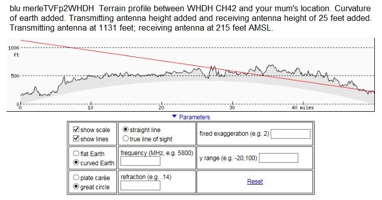

NBC is the weakest desired channel. Here is its signal coverage in Raymond. Magenta is very weak; no color is even weaker.

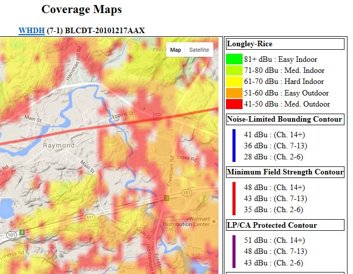

Here is a different Longley-Rice coverage map for NBC. Red is very weak; no color is even weaker.
The terrain profile shows that the curvature of the earth blocks the signal, but some of it can make it to Raymond by refraction. If you use the 91XG, it might help to tilt the front of the antenna up about 15 degrees.
