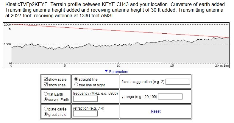

Hello, Kinetic:
You should get a good selection of channels if you use a Winegard HD7694P aimed at 66 degrees magnetic and the signal path is clear.(Corrected antenna model number)
An alternative might be the RCA ANT751, but I see a lot of trees in your area and the terrain in the signal path close to you is uneven.
Small changes in location and antenna height give a very different report. I don't have your exact address, but here is a report based on my estimate of your location:
http://www.tvfool.com/?option=com_wr...513429c8e8687a
moving up to 60 feet looks more like your report:
http://www.tvfool.com/?option=com_wr...5134fd343da105
If KBVO-CD on real channel 31 gives you MyN, you don't need to worry about KCWX on 5 or 8.
You don't need a preamp if the signal path is clear in that direction.
