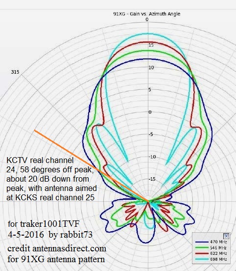

Signal strength is just about enough, but signal quality and symbol quality aren't what they should be. Signal quality is similar to SNR and symbol quality is the inverse of uncorrected errors. You want 100% symbol quality for no uncorrected errors.
I think I know what is going on. If you look at your tvfool report you will see a red "a" next to the KCKS callsign. This is a warning of adjacent channel interference, in this case from KCTV with a NM of 72.4 dB, making it 70.7 dB stronger than KCKS with a NM of 1.7 dB.
The signal strength reading you are getting might not be only from KCKS, it might also include some signal from KCTV spilling over into the KCKS channel.
TV tuners are expected to be able to decode a weak signal that is 33 dB weaker than a stronger adjacent channel. It is not known if your HDHR or the TV tuners meet or exceed that spec, but 70.7 dB is a lot more than 33 dB.
ATSC Recommended Practice:
5.4.2 Adjacent Channel Rejection
The receiver should meet or exceed the thresholds given in Table 5.2 for rejection of first adjacent-channel interference at the desired signal levels shown above the columns therein.
The antenna pattern for the 91XG will make KCTV 20 dB weaker when it is aimed at KCKS, so it is now only 17.7 dB over spec.
So, try the 91XG when it comes, with the HDHR and the TV tuners and let us know the results.
If you are not quite there yet, a custom filter, the two-antenna trick, or a shielded antenna enclosure are next on the scale of extreme measures for your grandfather.

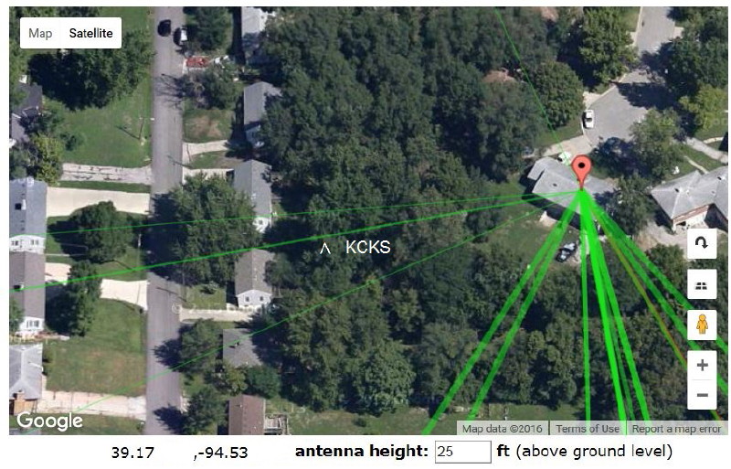

I have been making calculations based on your tvfool report which was done at 10 feet. I was curious to know how KCKS would look at higher antenna heights, but I don't have your exact location.
I derived two estimated locations based on your report. Both of my estimates are close together and have the same short coordinates as your report, but give different results for KCKS, while giving similar results for the strong signals, azimuths, and distances.
I think the big changes in KCKS with a small change in location are because of the uneven terrain in your area and the low height of the KCKS transmitting antenna as noted by Jake V.
KCKS Antenna
Antenna Height Above Ground Level: 220' 67m
Antenna Height Above Mean Sea Level: 1220' 371.8m
http://www.rabbitears.info/tvq.php?r...s&facid=187964
I assume that you used the coordinates for the location of your antenna for your report and checked them with the interactive map browser. The coordinates below the map change as you move the cursor to the antenna location.
I used my estimated locations for you and saw that there are a lot of trees in your area. I hope you can get the antenna above the trees.
I then used those two sets of coordinates, called Location A and Location B, to generate reports at 10, 25, 50 feet using the regular tvfool report:
Location A:
10 feet, KCKS NM -3.3 dB
http://www.tvfool.com/?option=com_wr...513470c8fd6329
25 feet, KCKS NM +10.5 dB
http://www.tvfool.com/?option=com_wr...5134b1a3b38c9e
50 feet, KCKS NM +22.2 dB
http://www.tvfool.com/?option=com_wr...5134fe89ad9246
Location B:
10 feet, KCKS NM +5.7 dB
http://www.tvfool.com/?option=com_wr...513412a9f8fd26
25 feet, KCKS NM +16.4 dB
http://forum.tvfool.com/showthread.php?t=15967
50 feet, KCKS NM +24.2 dB
http://www.tvfool.com/?option=com_wr...51345fc62009fe
Maybe your chances are a little better than I thought if you can get above the trees.
I'll send the coordinates I used to you by PM, so you can see how close I came.

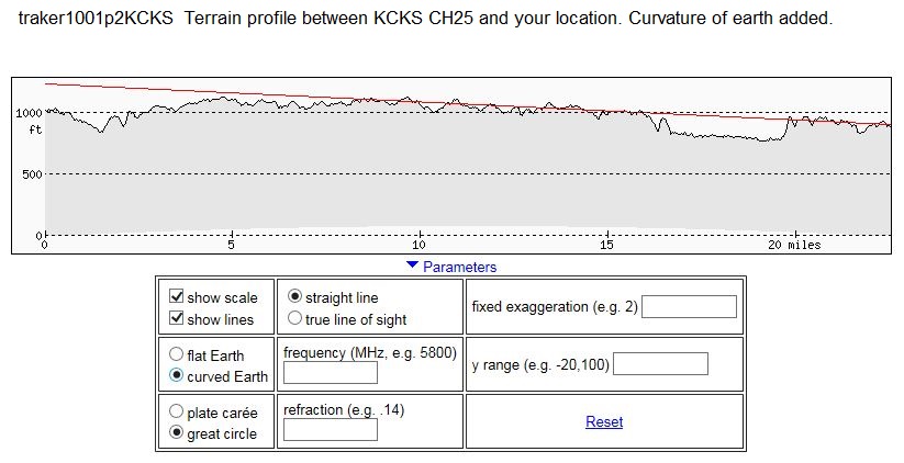

Here is the terrain profile between the KCKS transmitter at the left and your location at the right. You can see why the terrain causes a problem for the signal because of the low height of the transmitting antenna, and why raising the receiving antenna helps.

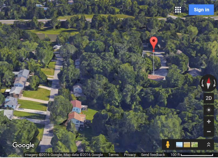

I did a tvfool report using your exact coordinates at 25 feet:
http://www.tvfool.com/?option=com_wr...513446ab1b8443
The NM difference is now only
KCTV 72.4 dB - KCKS 17.4 dB = 55 dB
55 dB - 33 dB adjacent channel allowed = 22 dB
22 dB - 20 dB from antenna pattern = only 2 dB away from spec
Raising the antenna makes the KCKS NM much better, with little change in the KCTV NM, because the KCKS signal is coming in at a very low angle and skimming the trees and terrain. You must get the antenna as high as possible to clear the path from the west.
Using a preamp is a last resort. The AD Juice and the CM3410 are more resistant to overload than the RCA TVPRAMP1R; see attachment 3.
RCA TVPRAMP1R max input UHF = -35.5 dBm
Antennas Direct Juice max input UHF = -21.3 dBm
RCA TVPRAMP1R SFDR UHF = 67.3 dB
Antennas Direct Juice SFDR UHF = 81.7 dB
SFDR is the difference between the weakest and strongest signal that the preamp can handle.
Even if the preamp can avoid overload, the tuner might be overloaded by your strongest signals. KCPT has a NM of 73.7 dB even before adding antenna and preamp gain. The preamp would improve the system noise figure, but you would need to add an attenuator after the power inserter to prevent tuner overload.
