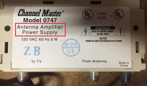

2. Get rid of what you're calling the "Channel View model 0747", it does not belong in the system. Most likely, you have an old, leftover power supply from a Channel Master CM7777 or CM7778 preamp still in the system. I'll have to check once I get to the lab, but it may well have burned out the VHF module due to applying power where power doesn't belong.
3. Solar panels have earned a deserved reputation for radiating interference into the VHF bands. Without a spectrum analyzer, though, this can only be determined by a process of elimination which still leaves considerable opportunity for misdiagnosis.

2) I'll remove the power supply. It appears way in the past I mistakenly thought this was a signal amp, day??? I returned the Clearstream 2v. any suggestions on what antenna I should buy in preference over the 2V or would you stick with the 2V

I researched the CM 0747 some more. Yep, it's the amp, but my wiring hookups never included the preamp. Go figure, maybe that's why I became a mechanical engr. - duh. But, it is interesting that the amp without preamp helps me get UHF, without it I get nothing. I'm going to start over tomorrow with a new antenna, pointed to the VHF channel, without amp. If this doesn't pickup the VHF signals I'll turnoff the inverters. Any other test cases I should do? Any explanation for why the amp alone helped UHF, what issues this could create, and should I try a pre-amp/amp if I continue to have issues?

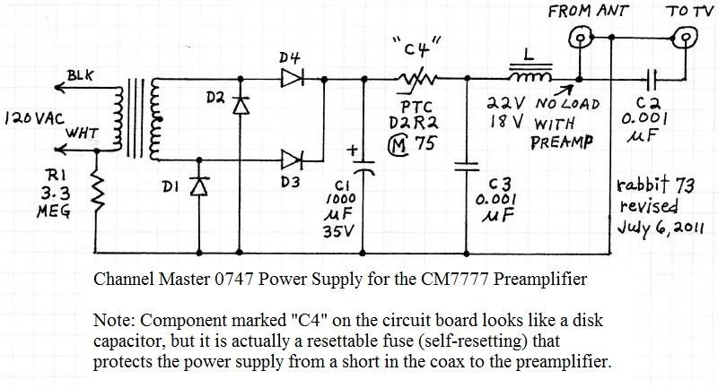

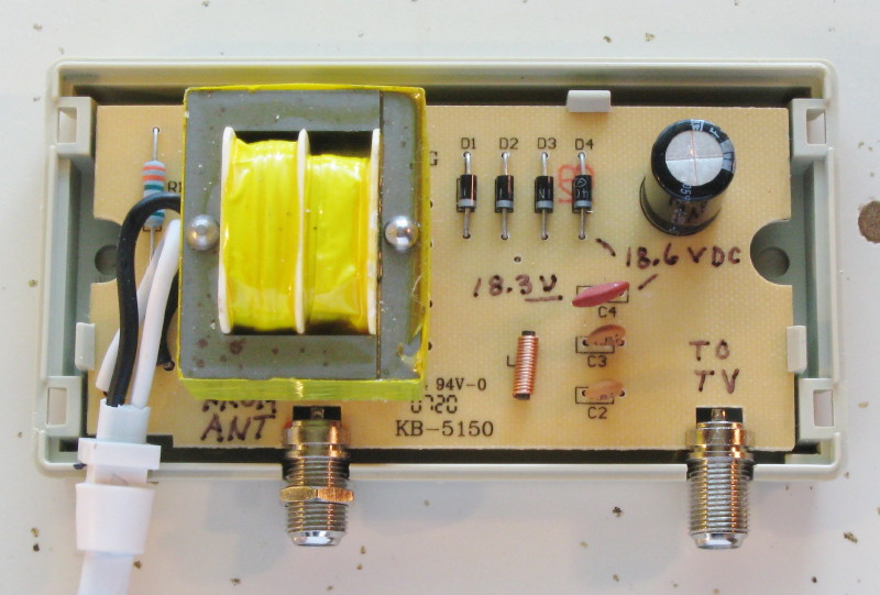

Sorry, but the CM0707 is not an amp, it is a power supply for the original 7777 and 7778 preamps. More exactly, it is a power supply/power inserter.
http://www.solidsignal.com/pview.asp?p=cm0747
There is no amplifier shown in the circuit diagram, only a power supply and power inserter. The power inserter is in the upper right corner, consisting of inductor L and capacitor C2 which allow the power for the preamp and the TV signals to share the same coax line to the preamp mounted near the antenna.

Rabbit 73, I should have taken the cover off. It's clearly just a DC power supply.
Does anyone have an idea why placing a DC power supply in-line helps with reception (without power supply no reception, with power supply over 20 channels received).
