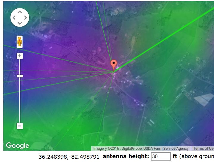

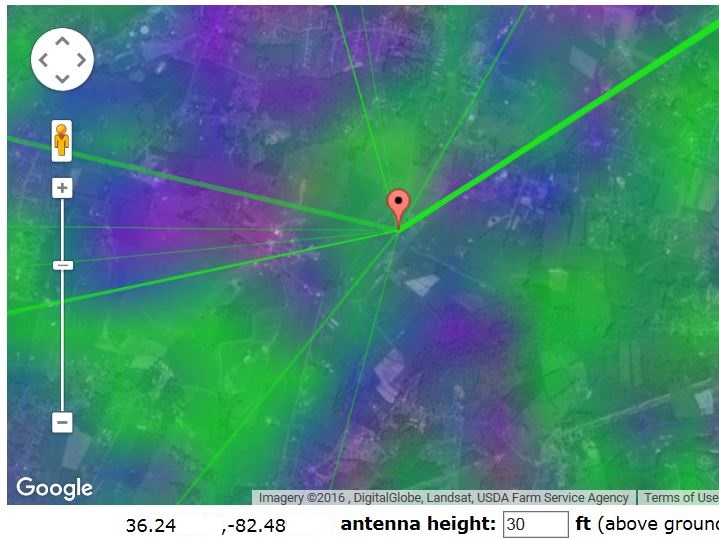

rabbitears.info seems to be more accurate than tvfool about NBC. CH28 isn't listed and CH29 at 15 kW is a construction permit that expires 4-26-2016. That leaves CH29 at low power.
http://www.rabbitears.info/market.ph...&callsign=wcyb
http://www.rabbitears.info/tvq.php?r...ems&facid=2455
The coverage for CH29 is very spotty in your area; you happen to be in a hot spot. For your protection, I have deleted all but two digits after the decimal point the way tvfool does it with coordinates in a report.
Here is the coverage map for a location near Bacon Branch Rd and Sliger Rd
at that location CH29 NBC has a NM of 0.4 dB
http://www.tvfool.com/?option=com_wr...51348a5f561bac
