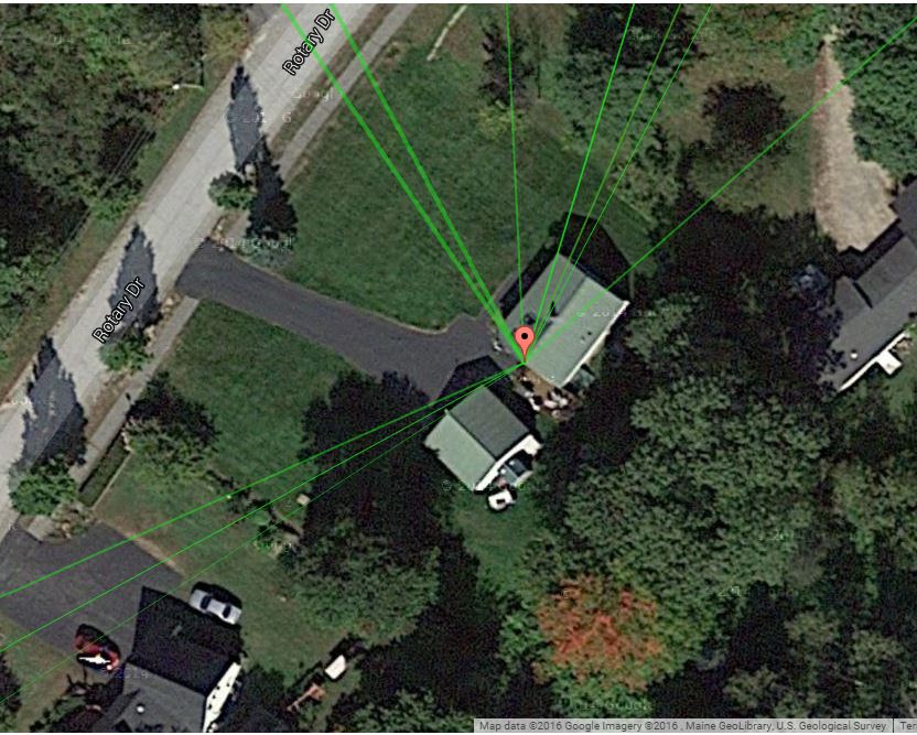

My current setup: CS4V antenna aimed at 28DEG (TRUE) and 20' up and 5 feet above the peak of my metal roof.
2 RS FM traps, PA-18, PA-18 power inserter, 3 way splitter (5-1000mhz)

You mentioned earlier that the antenna is above a metal roof.
As currently installed, is the antenna situated so that the incoming signals must cross the roof to arrive at the antenna or is the antenna mounted so that the signals hit it before crossing the roof?
Yes it goes across the metal roof. If you look at the attached image above you see where the antenna is placed. It is 5 feet above the peak of the roof attached by a gable end mount.

With a metal roof between the antenna and the transmitting tower you could be getting reflections of the signal from the roof. This can cause issues.
You may want to try a taller mast or move the antenna to the other side of the house to eliminate that reflection.
Of course none of that may work, but it needs to be eliminated and trial and error location testing is the only way to do it.
