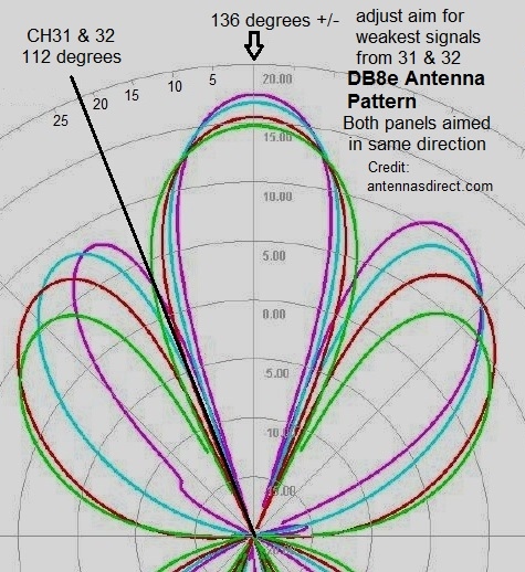

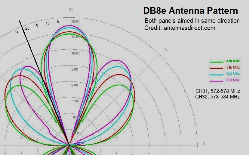

Reception of the weaker group of stations will require nulling of the two close-in stations and an overload resistant preamp. The DB-8e is the best antenna for you. The side by side panels have a natural null at about 21 degrees off axis on channels 31 and 32. Your strongest stations are 24 degrees off axis. The trick will be to aim the antenna so that 31 & 32 are as weak as possible. You'll have a 3 degree aiming error on your desired stations, but that won't matter.

Good idea by Tower Guy; that will help a lot.
Credit also to StephanieS for suggesting the Two-Antenna Trick, Outdoor which is the general method used to produce the null.

The two strong stations are at 111-112 degrees, and the weaker one's are at 136 degrees.

Ganging two DB-8e antennas may be the way to go, or at least worth testing.
No, you don't want 2 DB8e antennas. Your single DB8e contains 2 4-bay antennas that give you the null to make the strong signals weaker. Two DB8e antennas would make the beamwidth too narrow.
