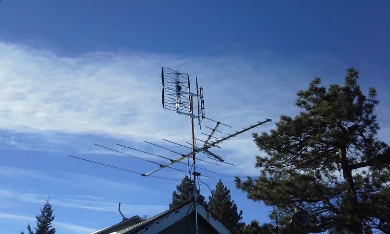

Trying a different antenna, added to a new mast above the other.
Dual Quad Bay Outdoor HDTV/DTV/UHF Bowtie
http://www.amazon.com/gp/product/B00DHHMOUW
Seems to have less drop outs on the channel 2, but still no other Denver locals.
Didn't play with it too much yet, still snow on the shady side...
Should I put a combiner up there and hook them together?

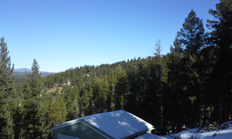

Here's a pic of my view to the tower
And the antennas

I'd try aiming the two panels of the UHF antenna in the same direction and try for Denver again. Yes, the VHF section of the 3036 can be combined to the separate UHF antenna.
Old 4-Jan-2016, 1:26 AM   #4
The RCA antenna connects to the VHF input of the RCA TVPRAMP1R preamp and the MCM Stellar Labs UHF panel antenna connects to the UHF input of the preamp. The preamp switch should be set to separate.
http://voxrightnow.custhelp.com/app/...-pre-amplifier
Sometimes the combined/separate switch of the RCA preamp doesn't make good contact with the VHF antenna. If that happens to your preamp, use a UVSJ to combine the VHF and UHF antennas. The RCA VHF antenna would connect to the VHF port of the UVSJ and the UHF panel antenna would connect to the UHF port of the UVSJ. Connect the output common port of the UVSJ to the UHF/COMBINED INPUT of the preamp, and set the combined/separate switch to combined.
Do not use a splitter in reverse as a combiner.
