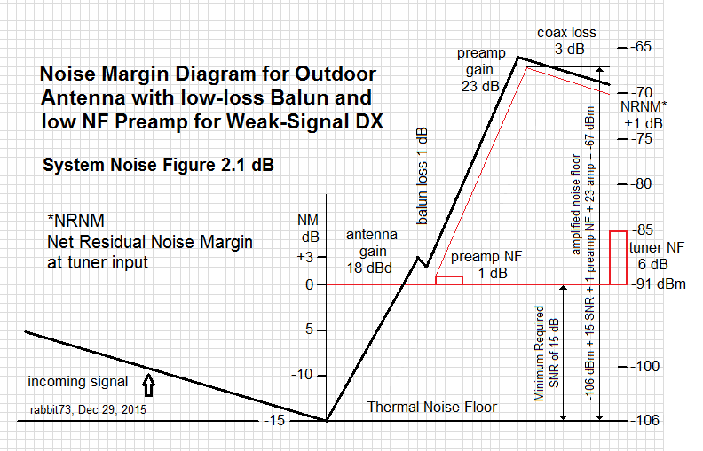

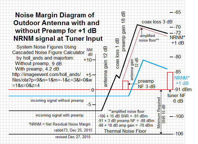

Special effort is required to receive weak signals with a negative Noise Margin.
Your tuner is stopping and moving on because the signals have a SNR below 15 dB.
Without a preamp, signals below NM -2 dB with an antenna gain of 12 dB can not be received because of the tuner NF that is added to the thermal noise floor and the minimum required SNR of 15 dB.
With a preamp, the antenna gain must bring the signal SNR up to at least the minimum required SNR plus the preamp NF BEFORE the preamp input, because the preamp NF makes the NM more negative.
Signals with a NM below -15 dB are buried below the thermal noise floor; antenna gain can not "pull them out of the noise."
Fortunately, the tvfool report has poor accuracy with 1 and 2Edge signals, and VHF signals can often diffract over terrain interference and the curvature of the earth to arrive at your antenna.

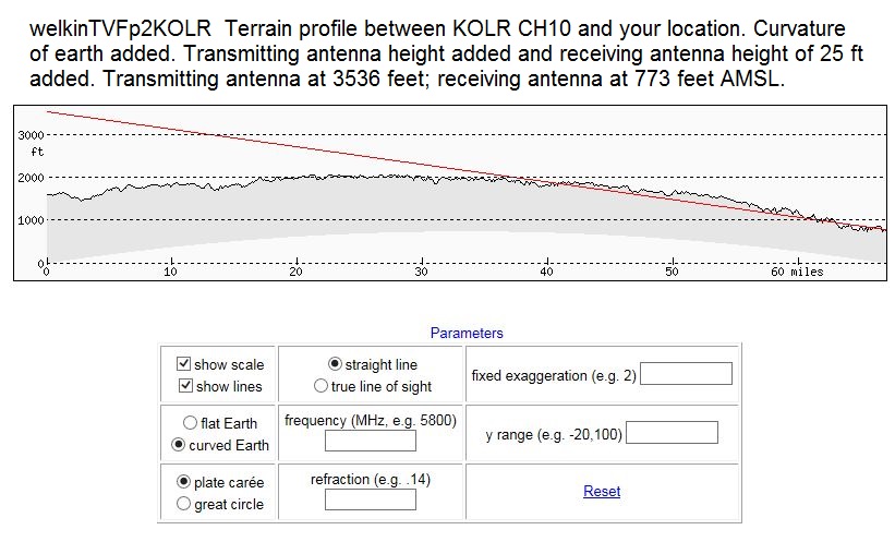

I am able to receive every LOS and edge channel with the exception of real channels 8 and 10......I had a TV up on the roof with 10 ft of RG6 and still wasn't able to receive KOMU or KOLR
KOMU at -18.3 dB NM is 3 dB below the thermal noise floor. KOLR is at the very fringe in a dead zone of the coverage map and blocked by the curvature of the earth. Your location has very rough terrain; small changes in location can make a big difference in the tvfool report. Here is the report based on my estimate of your location near the intersection of Goodfellow Ave and Procter Dr; look at the KOLR NM.
http://www.tvfool.com/?option=com_wr...b97d8f1ff9f5b9
KOLR coverage map:
http://www.rabbitears.info/contour.p...=1324294&map=Y
red spots, weak signal
no red spots, no weak signal
