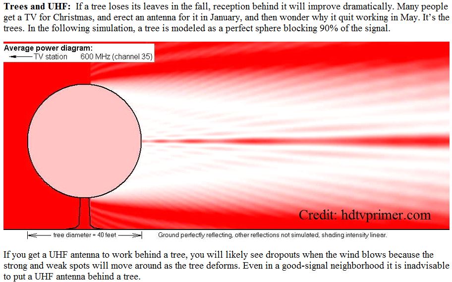

Also should I get a preamp because I am surrounded by pine trees.
Not good; trees will block signals. See attachment.
