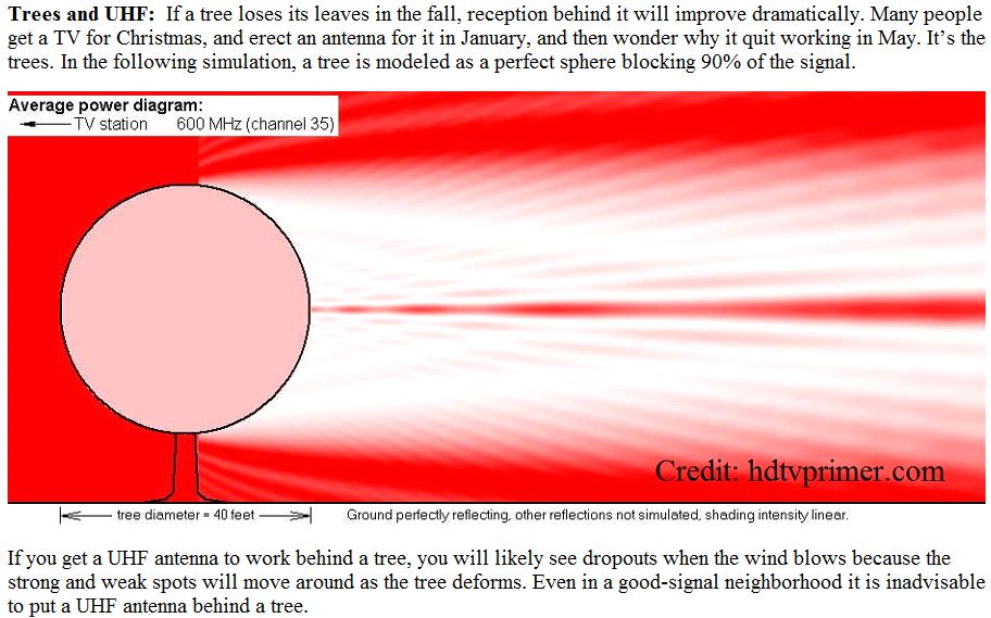

Could that have such a huge effect to knock out that one channel?
Yes, WGEN is on real channel 45, which is a UHF channel. UHF signals are affected by trees more than VHF signals. See attachment.

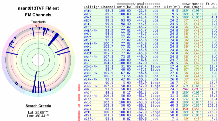

You have two strong local FM signals that might affect TV reception. If they do, you can insert an FM filter in the coax line. See attachment 2.
