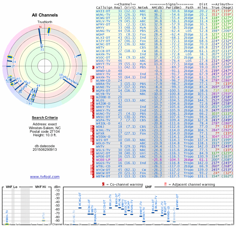

Can I have two separate antennas in my attic?
I have a new DB8e (serving my out of market Charlotte stations to my SW) (up in my attic) and an older Clearstream 4 (serving my local Greensboro stations to my (E - SE) at a lower level in my home. These are both used to serve two separate TV/receivers. Just to be clear, these are entirely separate with their own dedicated coax lines; and I am not trying to combine them in any way.
With that said, I am thinking about relocating my Clearstream 4 up to the highest point in my attic (to maximize reception) on one local affiliate (WGHP) that is somewhat weak and occasionally pixelates during the day.
However, here's my concern. I've got very limited space in the attic; and I've already got a DB8e up there serving a separate TV. So here's the question, can I relocate my Clearstream 4 up to the attic without causing interference with the DB8e? Again, I am not trying to combine them in anyway. However, I am concerned about multipath interference if I physically relocate the Clearstream 4 in close proximately (about 10 feet away) from the DB8e in my attic.
Can anyone advise me about this? Note: I realize I could place a lower powered preamp on the Clearstream 4 (which might eliminate the occasional day time pixelation on WGHP), but I'd rather relocate the Clearstream 4 higher---if it's realistic to do this without multipath problems with the DB8e. The DB8E will continue to be pointed to the SW and the Clearstream 4 (if relocated) would continue to be pointed to the E to SE. I appreciate any feedback on this.

It isn't likely to be a problem with a 10 ft separation unless one is in front of the other blocking the signal path. However, there are hot and cold signal locations in an attic and the most convenient location might not be the best signal location. I suggest a temporary setup test before drilling any holes and running coax through walls.
Since you have provided an image of you report and not an active link to your report I'm not able to click on the WGHP callsign to see the terrain profile and make a more accurate analysis.
It might help if it is only because the signal is weak, but it wouldn't help if the signal has poor quality, as defined by SNR and errors. If there isn't a good signal coming out of the antenna terminals, an amp can't recreate one; GIGO. The antenna must be located where a good signal exists. Hopefully, you have a TV that not only gives signal strength but also SNR and errors like my Sony.
I appreciate the quick feedback. Yes, most definitely, I would run temporary coax up there first (for the Clearstream 4) before doing anything permanent. I guess I can assume (once I do a test) and assuming it checks out okay...that I wouldn't get any surprises later? Perhaps, there's no way to really know that for sure. But I would sure like to think (hope) that a test would give me typical day to day behavior with that setup.
Here's an active link to my tvfool report (below). As far as a signal meter, all i have is the built in signal meter on my TiVo premiere. And I understand all these non-professional devices are like trying to compare apples to oranges. But I do find them helpful when comparing the placement of an antenna, even though it's not like a professional signal meter. Thanks.
http://www.tvfool.com/?option=com_wr...8e03fd60464f18
Btw- I ran this tvfool report with the default setting (for elevation of the antenna). I believe that first report (image) was ran with 10 feet above ground.

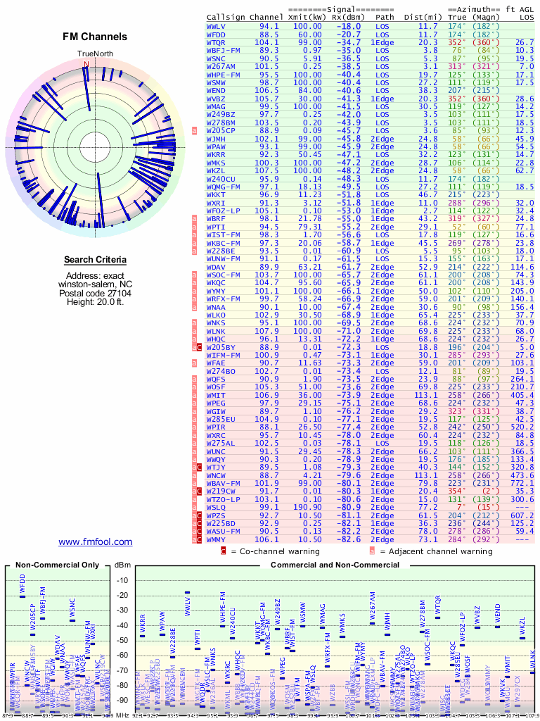

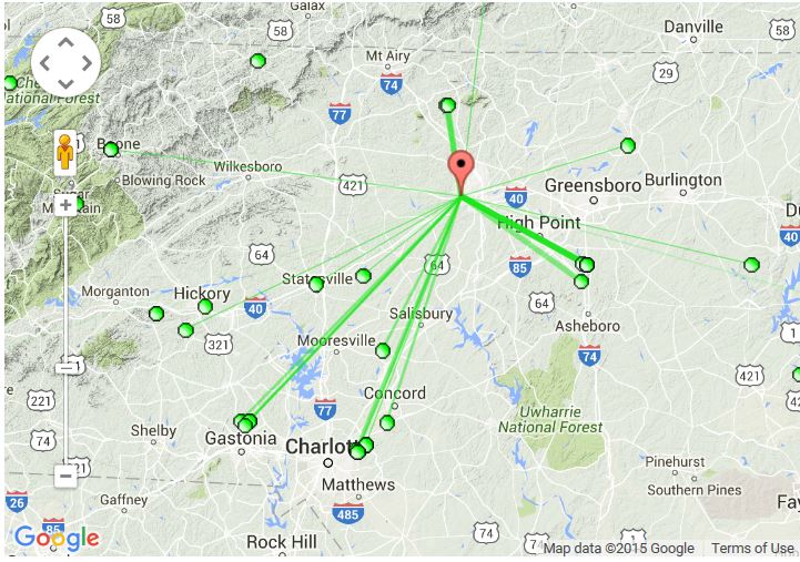

I wonder if your local FM signals are strong enough to interfere with TV reception? I did an FM report based on your estimated location:
http://www.fmfool.com/modeling/tmp/c...9/Radar-FM.png
FM filter:
You can do your own FM FOOL report here to see how close I came. FM reports don't link like TVFOOL reports:

Your report is almost exact to my address. I've just reran the FM Fool report (see attached). Thanks.
FM filter:
Does the Winegard LNA-200 have a FM trap? I ask that question b/c I have one of those here at the house. (It's not currently hooked up to the C4).
Yes, but, based on a recently purchased sample, it's largely ineffective below 100 MHz.
You need a full-band filter as all your local strong FM signals are in the lower half of the FM band.
