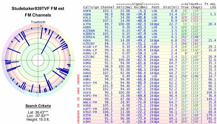

The first one that I notice is that there is a very strong FM transmitter, KOFM, in Enid that might be overloading your 30 dB preamp. See attachment 1.

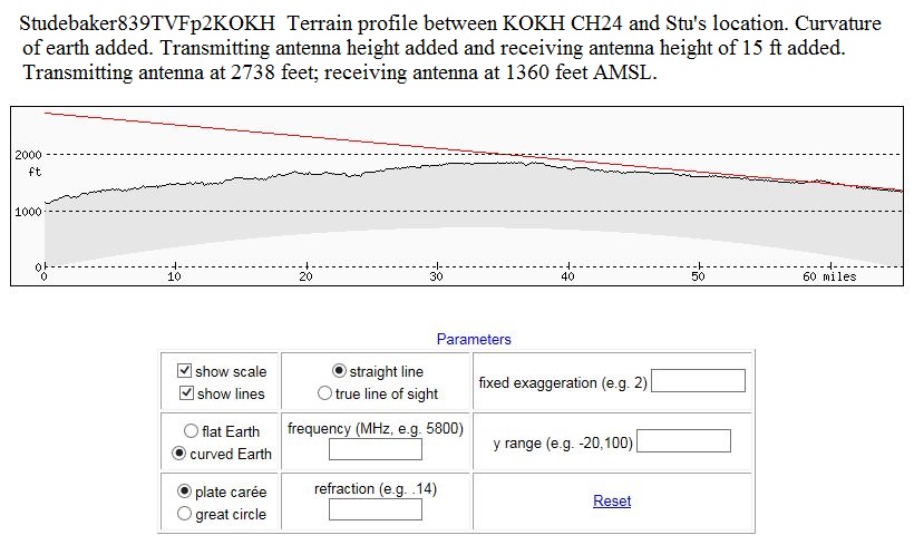

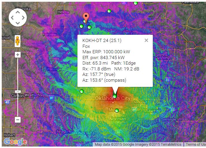

There isn't much signal left from Fox by the time it reaches your antenna:
and the curvature of the earth causes the signal to skim the terrain that has been heated by the sun:
1Edge and 2Edge signals aren't as stable as LOS signals.
