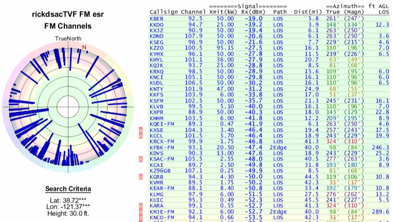

There are some strong FM signals that might be interfering with TV reception. See attachment 1.
I don't have your exact address, but if I estimated your location correctly, looking South shows a lot of stuff in the way. See attachment 2.
