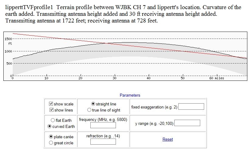

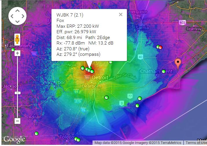

I suggest the Winegard HD7697P and a Channel Master 7778 preamp. Try the preamp with your present antenna first, then switch to the new antenna. The 7698 is bigger with a little more gain, but it is more difficult to aim because of the narrower beamwidth; that's the trade-off. The CM 7777 preamp has more gain, but it is more easily overloaded.
was wondering whether a directional bow-tie antenna might be the way to go.
Most bow-tie antennas are for UHF only. You need an antenna for UHF (real channels 14-51) and VHF-High (real channels 7-13) for CFPL 10, CBET 9, and WJBK 7.

definitely trees and windmills in the path however
Trees can block signals.
You have terrain interference because of the curvature of the earth, but the signals can make it over the peaks to a certain extent because of diffraction. I don't think you can expect 100% reliability. You can see that your location is on the fringe of coverage.
The coverage and terrain profile for CBET are similar, but it is at a slightly different azimuth.
